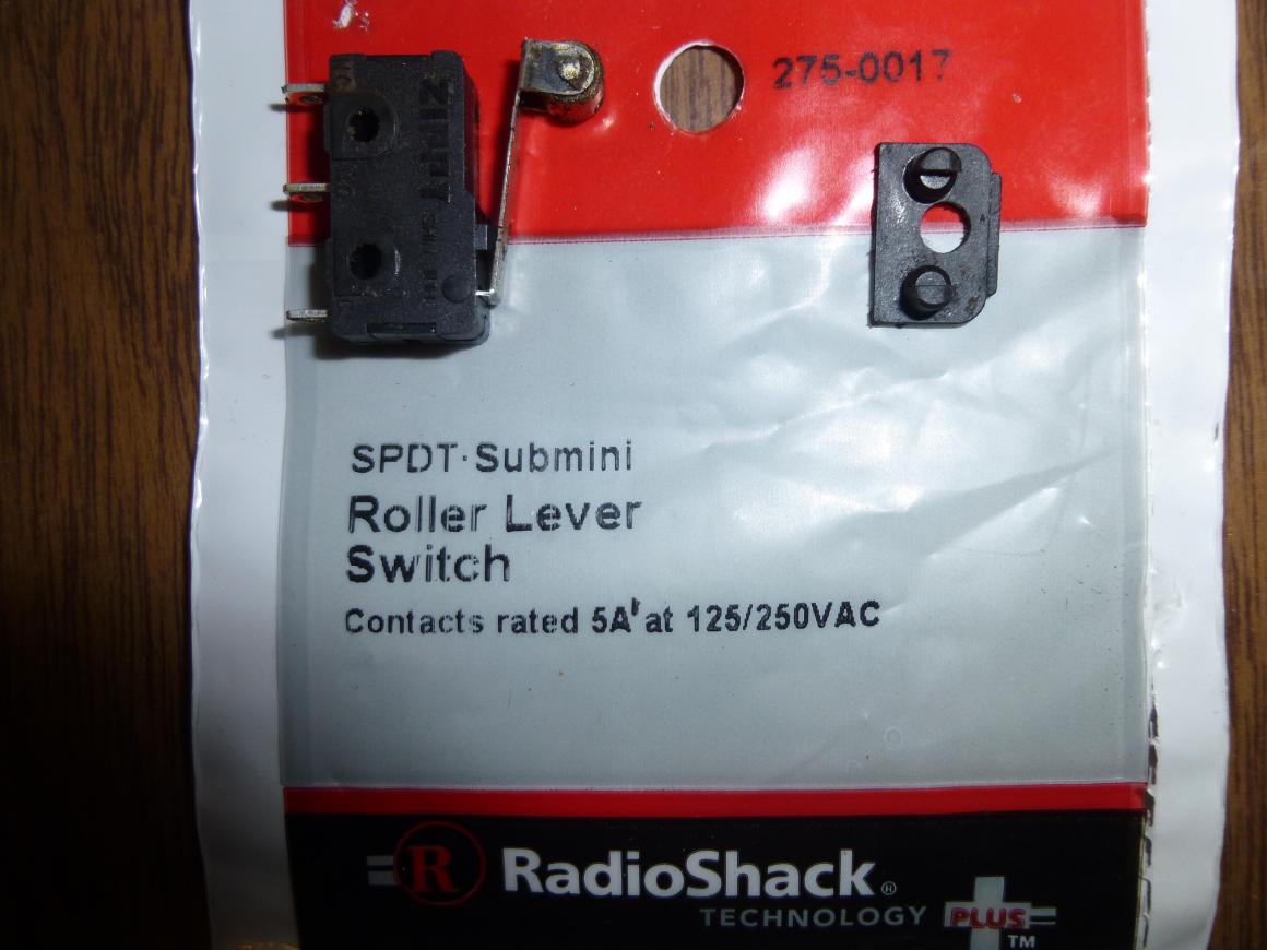

If you're cheap like me, go to Radio Shack and buy catalog #275-0017. It has a roller at the end of its lever. You can also buy one with just the lever, but I was hoping to make use of the roller to extend its life and reduce wear on that cam, which was showing damage from the OEM switch.

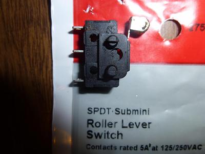

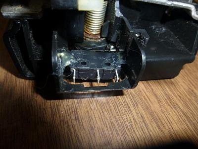

I was able, using a very sharp knife that I kept my fingers away from, to first remove the piece of plastic with two nibs on it from the OEM switch. I call this piece the 'locator'. This made it easy to confirm the exact position of the new switch on the latch mechanism ahead of time. I glued the locator to the new switch first, then placed the switch on the latch mechanism, confirmed open/close operation, then hot-glued the switch to the latch. I've read about people drilling new holes to mount the new switch, but I was more comfortable with something less drastic. It doesn't deal with a lot of stress. Then solder the wires on (tip: clip the wires off the old switch very tight to the switch, as I had to extend one wire 1/4" because it was short) and reinstall.
You'll see in my photos (hopefully) that the locator is aligned just below the semi-circle outline of the new switch but above the hole. I'd err a little towards the locator being close to having its edge snug up to the hole (moving a little left in my photo relative to the switch) as I had to use needle-nose pliers to tweak the lever a bit for a more 50/50 operation where the switch engaged half way as the latch closed.
Oh, one more detail: with the switch configured like this, in case you can't read on the switch, you are using common and normally open.
