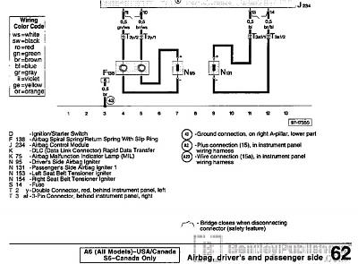

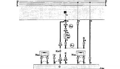

I'm almost done with replacing the full TAN interior of my 1998 A6 with that of one from a BLACK 2000 A6. I have come to one last porblem I can't seem to find a fix. The air bag sensor connector under the 2000 A6 front seats are 4 pin with 3 wires, brown, green and black, and the connector from the car is two pin, two wire, green and brown. The wiring diagram for the 2000 seems to indicate that the brown is a connector ground, but I can't find any info of the 98 wires. Before I splice these wires can someone please help with what goes where.

Sorry I made a mistake the green wires should be blue, that is :
2000 Connector: brown,blue,black
1998 Connector: blue, brown

This info is under 1998 Avant - AFC engine
Attached Thumbnails air bag connectors -- HELP----abagbottom.jpg   air bag connectors -- HELP----abagtop.jpg
