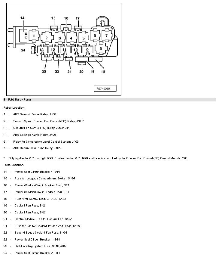

According to the online manual that I had the 2001 A6 had only two fuses that were located behind the driver's side storage (underneath the instrument panel). My car only had places for fuses in locations 19 and 21. Both of the fuses were the standard fuses and were in tact. If you notice the * it states that relays are in the control module in years 1999 and later.
