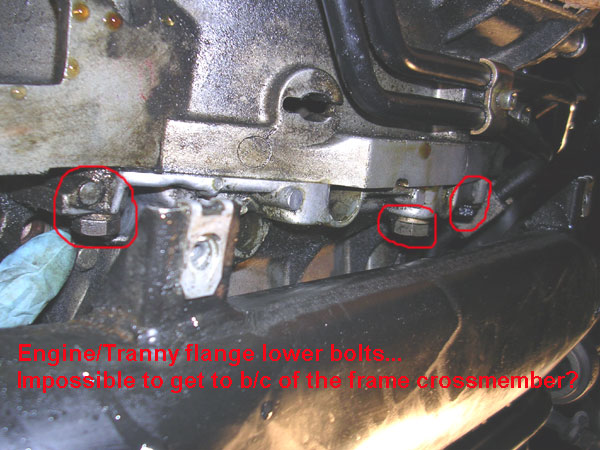

I am nearly close to get it done. However, I have a question of my own - more like a bump in the road.
Bentley says:
I'm using a jack to support the transmission from underneath, regardless - that's not the important part.
I ran into a problem regarding the flange lower bolts - only 3.
They're located right above the frame big crossmember as you'll see in the picture.
If anyone with a C4 have pulled their engine, please throw me a bone as HOW DID YOU UNBOLT those $$^&&^ers?

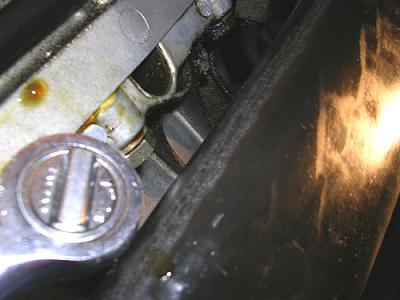

The only way I can picture of getting some room to fit a wrench/ratchet in there somehow is to remove the sway bar, which will provide just a little room to run an extension in between the edge of the oil pan and top of the crossmember. And even then, I'm not sure I'll be able to find the correct extension length that coupled with the 16 mm socket would not run into the oil pan.
This is really puzzling me and makes me (again) irated with Bentley Publishers'. They get another black mark by their name from me.
So, any ideas beside removing the sway bar?

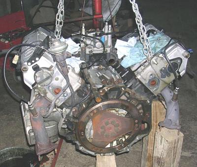

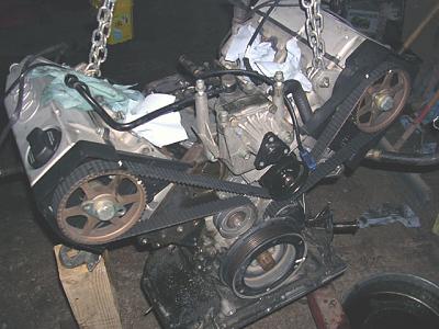

The beast capitulated... It put up a good fight, gotta give it to "it".
Maybe I'll put together a write-up when all of this is over... Got a long list of things to do until the car will be back in one piece.

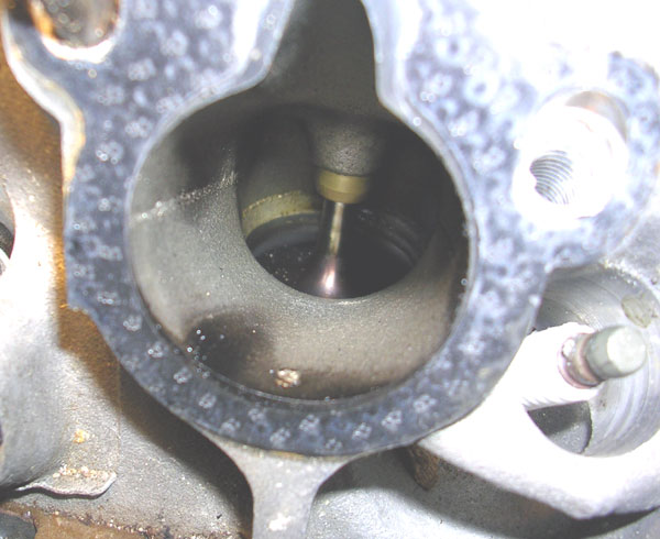

Well, at the time I thought I had a head gasket leak - didn't know much about the engine (not that I claim I know much more now
I started with TB, WPump and Tstat replacement and I found lots of oil mixed with coolant on top of the valley pan. In my mind, I thought I had a problem so I decided to replace the head gaskets...LOL...That's why the heads came out.

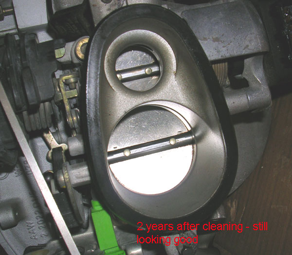

Camshaft seal on the same bank and the valve cover gasket started both leaking, so I suspect the valve, b/c the breather hoses on both heads are clean and the throttle body flaps are still crystal clean/r after 14,000 miles and close to 2 years.

).I started with TB, WPump and Tstat replacement and I found lots of oil mixed with coolant on top of the valley pan. In my mind, I thought I had a problem so I decided to replace the head gaskets...LOL...That's why the heads came out.
