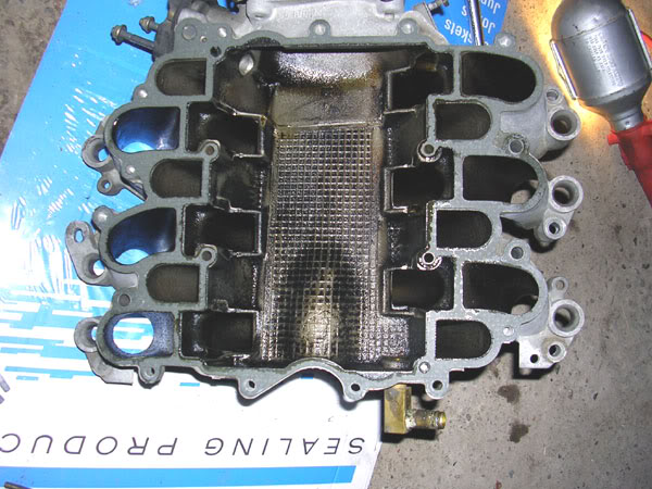

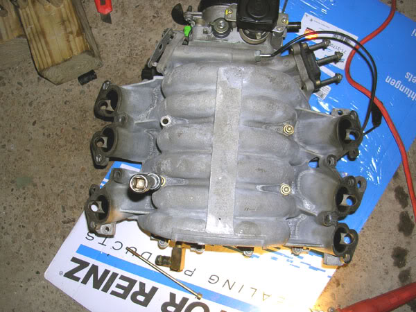

With everything cleaned up and "spiffy", I HAD TO open up and check the intake manifold before installing it.
It turned out that it was coated in oil, although not in a horrible shape. It too got a nice bath after only 15k miles... With everything tight now, with new seals everywhere and new oil valves + "pcv" valve, I hope that the engine will stay clean for some longer time.
Getting really close... I'm modifying a bit the "breather" set-up, which hopefully I'll finish tomorrow, but other than that I'm very much so ready to fill her up with coolant, PS oil and transmission fluid.

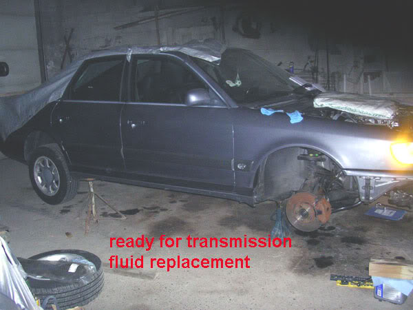

By the weekend she should be on her wheels so I can torque the control arms bolts and nuts.

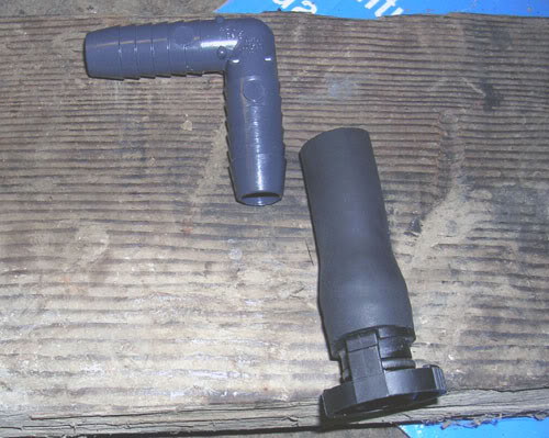

The bank2's breather hose snapped on me - it was very brittle anymore.
So I had to modify it instead of spending anymore upwards of $ 95 for a damn piece of plastic. The end going into the air box had the locking ring broken ever since I got the car, but I got bye with it. Now I tightened it with a piece of wire... (I know...I'm a cheap bastid).
The brake booster's line is still ok, but I replaced the other sections between the vacuum pump and breather hose (one whole piece - found @ O'Reillys for GM trucks; it fits perfectly), and between vacuum pump and manifold (with a simple L-shaped elbow and two pieces of hose.

I also replaced the transmission filter and pan gasket, and I need to finish filling her up with ATF.
