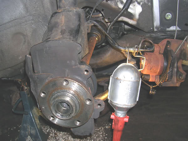

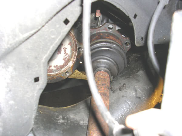

Nevertheless, undo the brake caliper bolts - two, slide the caliper off and hang it safely without disconnecting any lines. Undo the caliper bracket's bolts - two (I believe 16 M), pull off the rotor and you should be left with something looking similar to this:

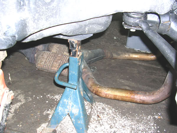

Next - I realized it would be easier just as the manual says, and dropped the exhaust (you can take it off before you start on the cv axle - your choice if you go this route):

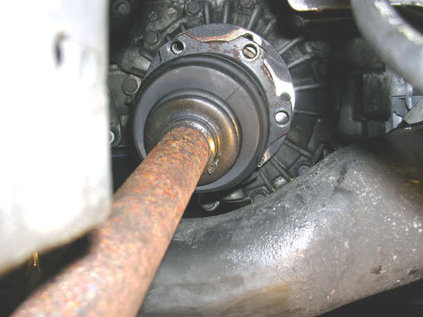

Undid the CV Axle's inner bolts that connect it to the differential's flange:

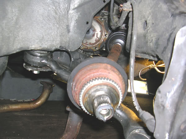

Remove the axle's main bolt now - is (or should be by now) already loosened up. With the exhaust downpipe out of the way, you can wedge the axle to the right (toward the front of the car), under one of the exhaust's studs and around the flange's edge. Then just slide out the outer end toward the differential (of course) and you should be able to free it.

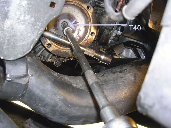

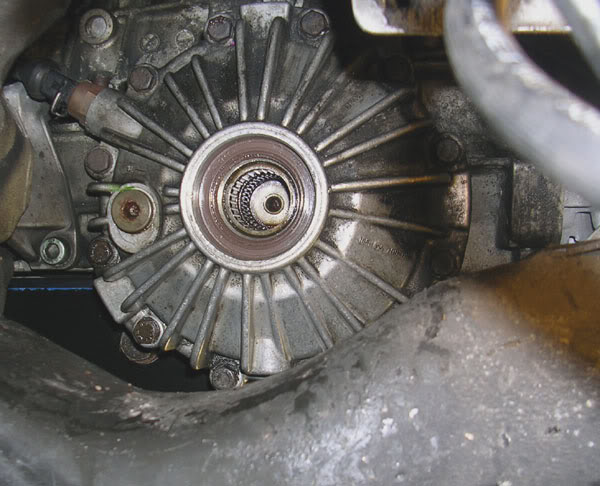

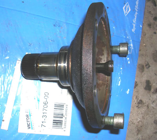

Now you can see the flange exposed - the target is the little bolt right in its center (T40 socket bit needed). To remove it, you need to thread two flange bolts back in and hold counter with a small tire iron, wrench extension, etc.
The bolt is only torqued to 18 ftlb so it shouldn't take you too long to undo it.

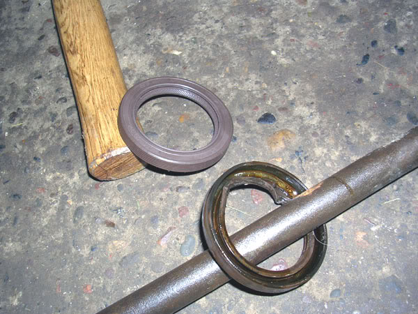

There's the differential opening staring at you. Let all that old gear oil drain (grab a cigarette or a beer meantime) and then grab a small tire iron. You'll take the old seal out. The book says to be careful not to pry on the flanges. They're right as you don't have much room to maneuver that tire iron around as you please.
Take your time and pry a smidgeon at a time; You can even use a sturdy, solid and long flat head screw driver... Just be careful not to pinch the interior flanges of differential's opening. I would have used a normal seal puller but there's no room or angle to operate it in there. (I guess that's what those expensive and fancy VW/Audi tools are exactly meant to do )
Eventually you'll get the seal out.

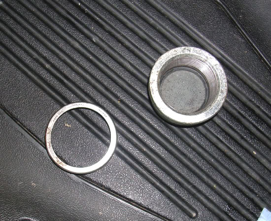

While the flange is still out, undo the fill plug - you can see it in the picture (8M Allen socket bit or regular L-shaped wrench).
