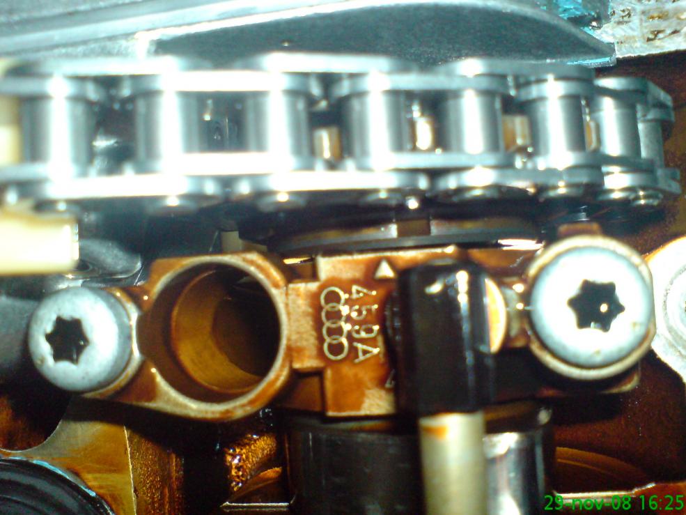

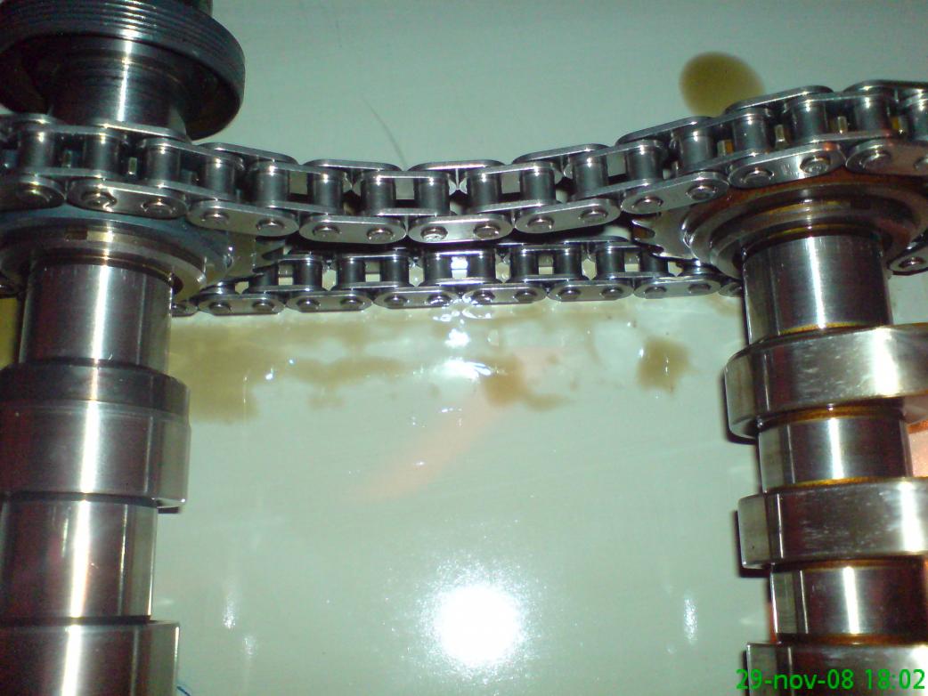

the mark om the camshaft dont match the other mark. its only the left cam on the right side of the engine that dont match the marks. the chain link rollers is 16 between like it should.i have changed the chain and the chain tensioner too.

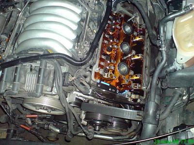

is the foto nr 2 right? the tooth and the mark align but on the manual foto the mark and the chain roller should align..

On the fourth picture, I count 15, not 16.

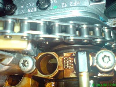

now i have tryed one more time.. the intakecam is still of by 4-5 mm(foto nr 3). when i run the vagcom i got about 6 degrees of before TDS.
at foto nr 1 you can see that the tooth line up with the mark,if i compair it to the bentley foto its wrong. it should line up with the chain roller..
foto nr 2 and 4 shows it all but not so easy to see..
