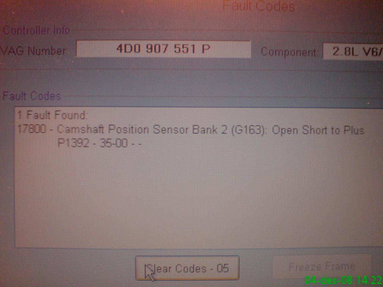

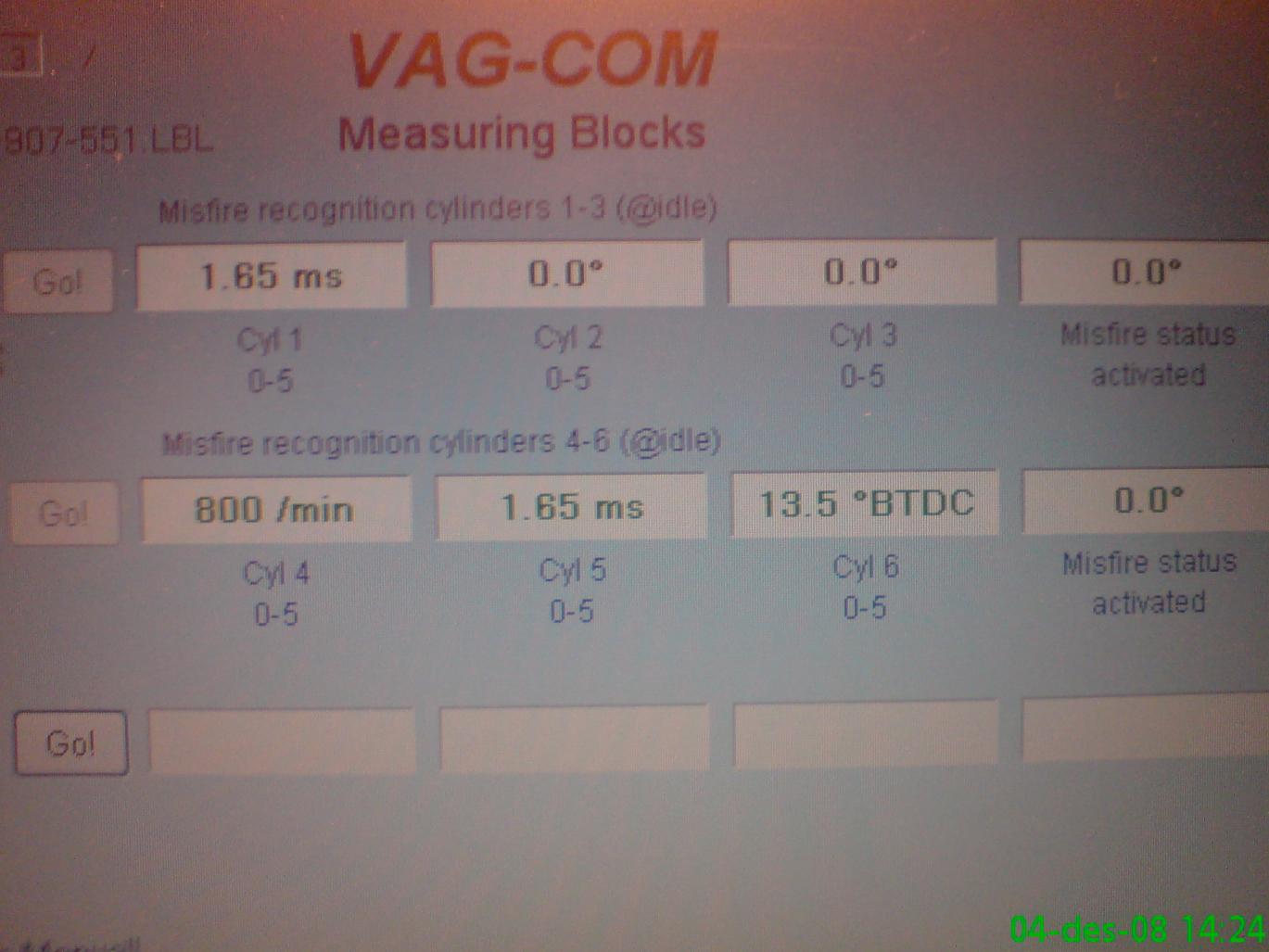

Old Dec 5, 2008 | 04:14 AM
  #29
beemerfanatic's Avatar
Posts: 143
From: norway
at foto nr one you could see the code. at foto nr two you can see that there is something wrong:-)

From: Northern California
Well obviously bank 2 cams are off. If I remember correctly the cam position sensor at the rear of the head is feeding off of the exhaust cam. If the cam position sensor or the pick-up was damaged, your car should still run fine. But the fact that it is running like crap is indicating something is actually misaligned. (duh...) Well if you are still up for messing with it, I would try what loach1 suggested first. Maybe I am way out of my league, but I would try retarding the intake cam by 13.5 degrees. (Count the number of teeth and divide 360 by the number to figure out the number of teeth to be moved) Since our motors run clockwise, you would need to lengthen the slack between the two cams. Do that, reset the timing belt and give it a shot.
