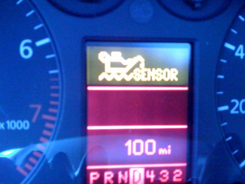

It came up today when I turned the car on and put it in drive. I've never seen this icon before. I've looked thru the Bentley and can't find it there. Any thoughts or ideas would help. Also any ballpark figures on how much repairs for something like this would be.

Looks like it's telling you your oil sensor is bad - my guess would be the sensor that lets you know when your oil is too low? Again, this is just a guess. My estimate at repair would be cost of sensor + installation (@ dealer $90/hr) = around 250-300. They quoted me 300-350 installed for an 02 sensor when I thought mine was bad due to the p1127 code that came up on vag-com. Turned out to be my air intake boot was ripped, throwing the code and was only $121.85 installed )

^^ Correct
Engine oil sensor faulty
