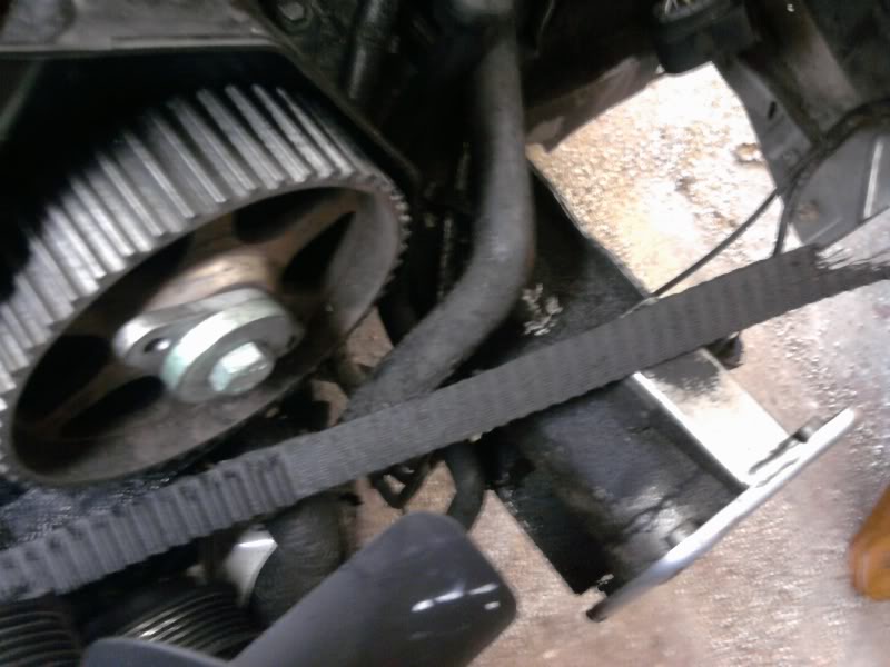

The results are in - timing belt is broke. Heads are coming off the car today so we'll know for sure how bad the valves, etc are today.

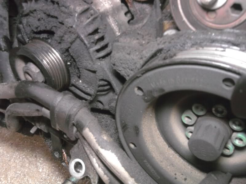

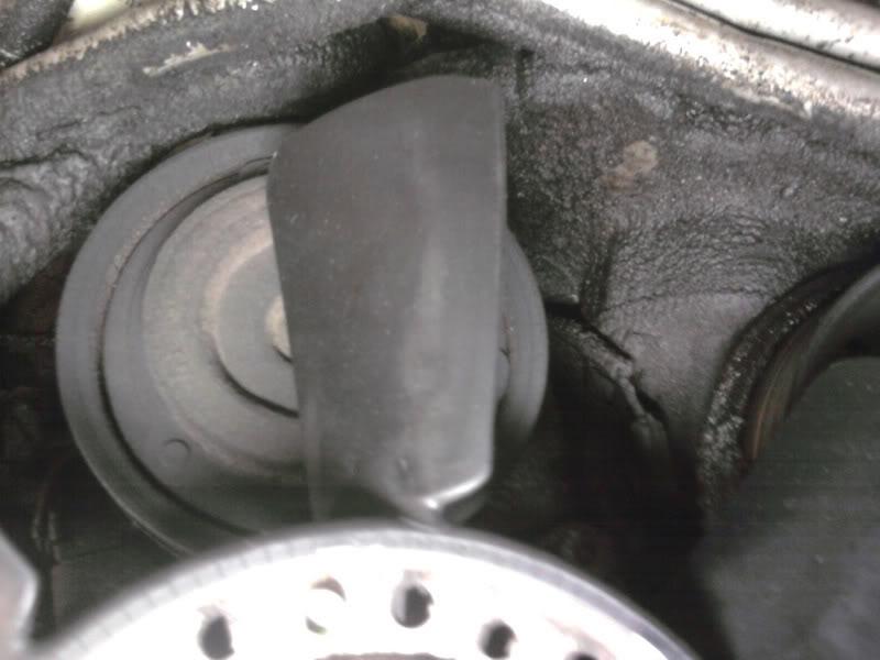

Anyone ever seen this much gunk and buildup around the front of the motor? Can you say "deferred maintenance"?

Good plan -- spend a few hours see how much work is needed.
You now know where all the pieces ot the TB went. I wouldn't be suprised if there was a bit of surp belt there also. My guess is that the TB has nevfer been replaced and you were lucky to get to 191K.
Watch out for a seized cam --- sometimes the oil passeges get clogged, the cam seizes and the TB breaks... You'll be able to tell by the color of the cam caps...
What exactly would I be looking for there (color wise)?

number 2 and 6 pistons are junked and the valves are shot as well.
Anyone have a 2.8l 30v that would fit a '98 A6?
