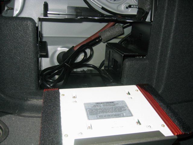

Here are a couple of reference pictures for you:
This is the changer mounted inside the trunk bracket:
However, the changer is secured in place from screws on the SIDE of the changer, which are nearly impossible to secure withthe bracket inplace, so best to remove the bracket from the car. You can see the mounting screws in this picture (ignore the DVD player below the CD changer).
Size:  59.5 KBThe black screws are M5x7 if I recall, which I found at a local auto parts store.They might be on the changer you find, they may not.
Bracket removal
You can see a few of the mounting points in this picture. It is held in with three bolts and one screw.
1. Remove the tool tray from the trunk cubby
2. Loosen the screw that ison the lower right side of the bracket. You can see the downward-facing slot in the lower right of the picture above. The screw is in an akward location, and you'll need a short philips-headscrewdriver. You only need to loosen this screw (note it is a short screw), you do not have to remove it. Ifyou remove it, it is a PITA to replace later.
3.Remove the bolt in the lower left, which istucked under some sound insulation pads below the tail light.You can see that mounting point in the lower left of the picture above. Just peel back the insulation and you'll see that bolt hiding there. Careful that you do not drop the bolt into the black-hole of the rear fender...you may never find it again!
4. Remove the two bolts are located above the changer slot. I think there are two arms one longer than the other. The bolts are at the top of those arms.
Changer Cable
Here is a picture of the foam-wrapped cable end that you wil need to find. This is from a B5 S4, but the cable looks the same. It is tucked WAY up in the upper right of the driver side trunk cubby, zip-tied with a few other wires. The round connector is covered with the gray foam piece.
Plug in the CD changer, make sure it works first.Power on the radio and eject the CD magazine, load a few CDs (labels face down in the magazine's tray) and make sure it works. Then reintall the bracket and voila! you are done!
