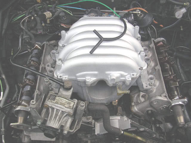

You'll have to remove the whole manifold. You can't separate the upper from lower chamber, as it has 4 bolts that screw in upward.
In order to unscrew a couple of bolts in the front, the PS pump has to come unbolted to get it out of the way (without disconnecting the hoses). You'll understand better what I'm saying when you'll actually do this.
Here's a little help as I didn't take pics of the actual removal.
Found a pic with the PS Pump out of the way:

You'll have to buy new gaskets:
- intake manifold to cylinder heads x 2 (lower gasket) = $ 2.12 x 2 at ArizAutohaus
- upper to lower manifold x 1 = $ 9.71 at Ariz Autohaus
- Throttle body gasket - that's about $ 4-5 bucks (you may be able to find it at a local parts store) -> only if you choose to dismount it from the lower manifold
I soaked the manifold sections over night, so you may plan to do it over a weekend to do it "right".
