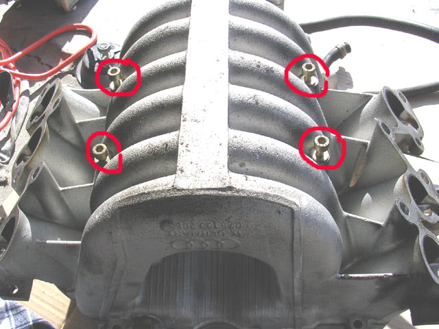

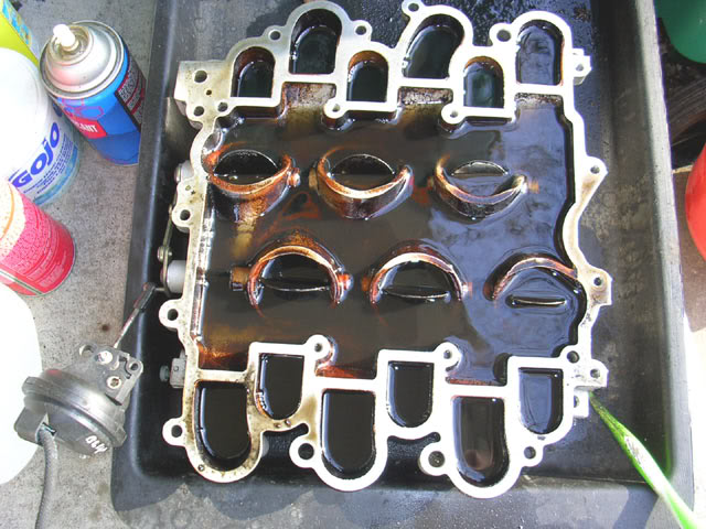

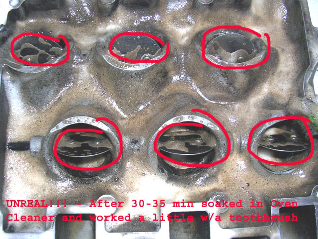

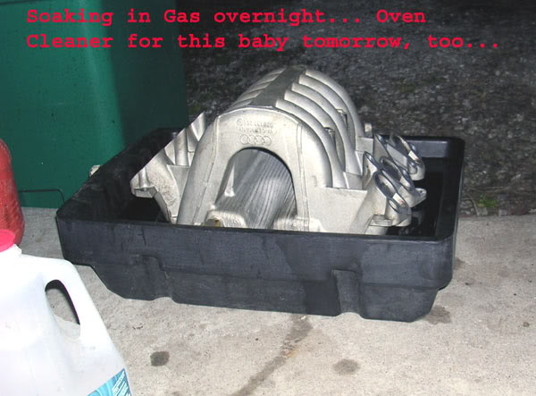

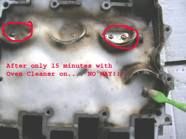

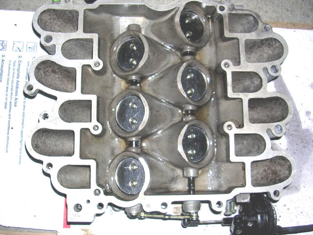

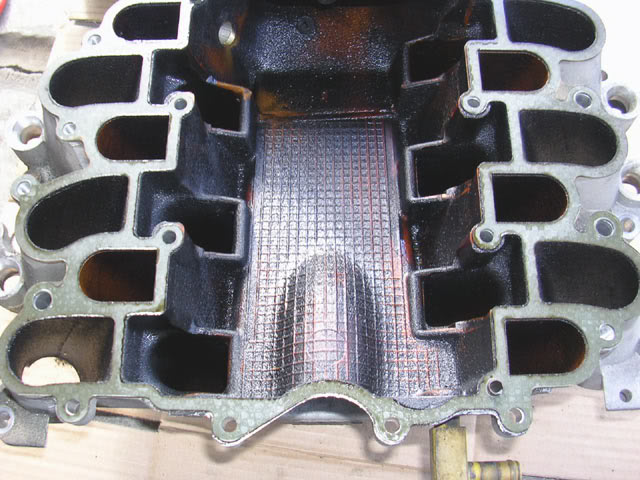

I didn' have much time to work on the car (only a 3 hr-window after getting home before the dark sets), but it was a good day.
The intake manifold is cleaned... The exhaust is soaking in gas until tomorrow and it will receive the same treatment as its omologue.
To keep things brief, I would only say that 1 1/2 hrs soaking in gas is worthless. The OVEN CLEANER knocked the s&*t off in 30 minutes...
I wasted 2 gallons of gas for nuttin'...
Anyway, here are some pics.
tomorrow is another day...indeed
regards, guys.
I wasted 2 gallons of gas for nuttin'...Anyway, here are some pics.
regards, guys.
Ya.. gas soaking is pretty much worthless. Good job otherwise.
