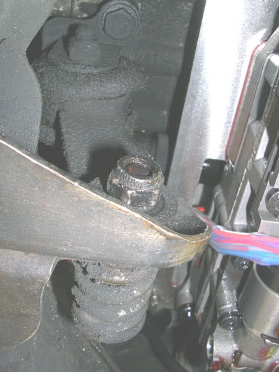

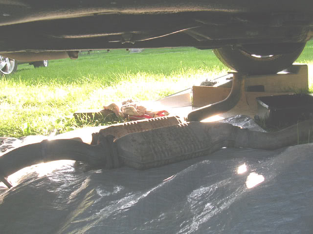

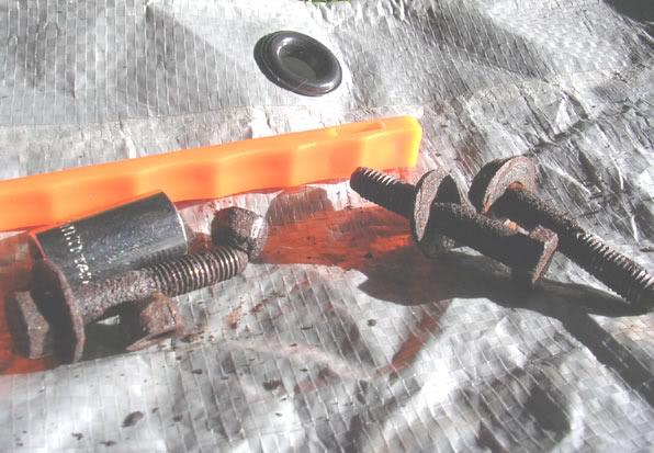

You're in for some good, fun time indeed. Make sure you PBlast the bolts in advance, otherwise you're in for anything else but fun.
You got three at the flange between the exhaust heads and the downpipes, three more at the Y-connection to disconnect the passenger side cat - otherwise you need to drop them both if those are too rusted, though eventually you'll still have to remove them; and three more at the flange connecting the cats to the intermediary pipe.
