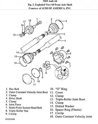

The breakdown..
Old Nov 9, 2010 | 04:07 PM
FingerLakes's Avatar
Joined: Apr 2010
Posts: 33
This one is bigger..

There is no part named "pinch bolt" on your "The breakdown"
As I suspected - you are referring to the "Hex bolt"!
