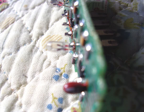

Long forgotten thread...I thought I'd update it with some pics for the ones stumbling in the future upon it out of need and wondering about it...
I myself never have had a lit gear shift display since I bought the car. Since the voltmeter and analaog clock's bulbs went out, it was a good chance to fix it as well.
Looking for information, I came across two wonderful write-ups which were very useful to me - needless to say that I must pay credit where credit's due.
One and the other
This is how the various bulbs are located on the board (the orange and blue units):

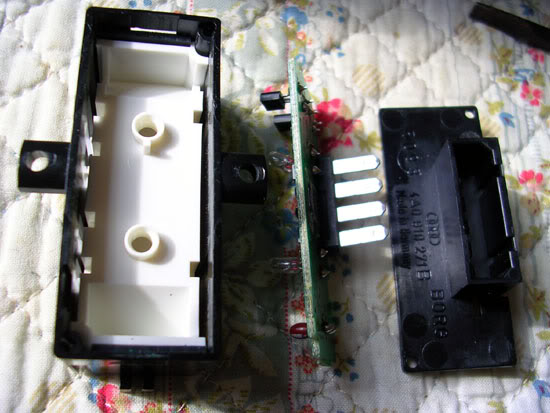

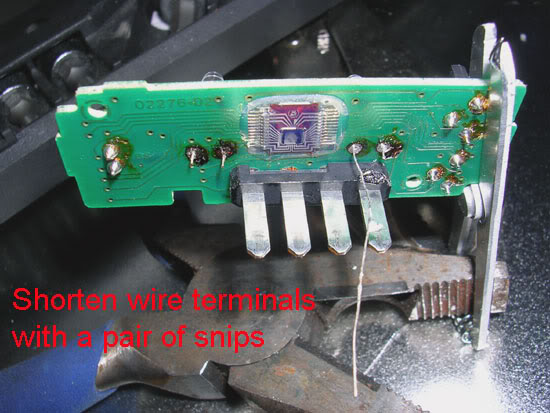

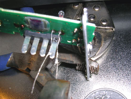

As far as the Transmission range (or gear) Display:
