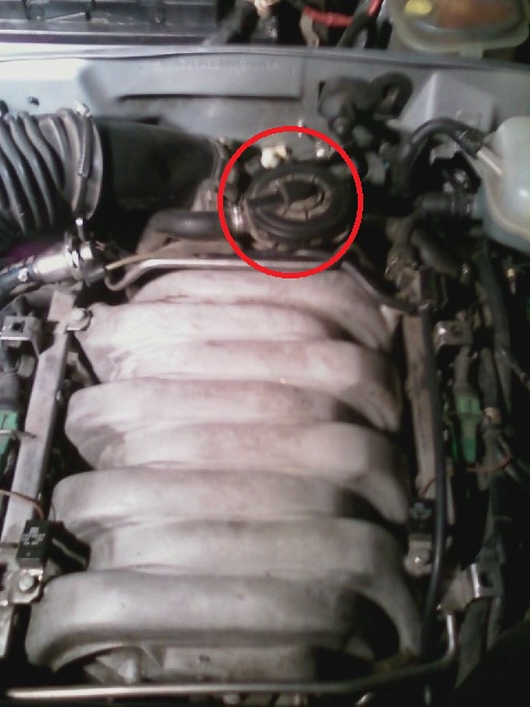

So i changed out all of the vaccum lines tonight and made it waaaay worse.
The car wont even hold an idle. Really rough and the CEL popped up right after I turned it on. Also, there is a secondary breather (i'm assuming thats what it is) on the top rear of the enging that is sucking in a TON of air. (circled in red) if i cover the inlet of it with my finger it will cause the engine to sputter. What the hell did i do wrong and how do i fix it? I changed out the lines one at a time to ensure they all went to the right connections? WTF?
And to make it worse, I'm on vacation and drove the car to Chicago. If I cant get this thing fixed I wont be able to drive it back to Tucson. If anyone knows a good mechanic in the area or can help please please shoot me a line asap.

Looks like the PCV valve, that doesn't have that much pressure. Duct tape that turd up until you can replace it, hell duct tape any line you hear leaking. If you're on the move i can't tell you how many times a roll of duct tape has saved my ***, especially when i was on the 10 going thru Indio CA and an intake line ripped. The ECU has adapted to running with a vacuum leak, once you plug all the leaks it will compensate and return to normal.

thanks man, im stationary right now for the next few days so its not a big deal. so that PCV valve might be the culprit???? would the ECU remember the running conditions of before even if i disconnected the battery? i'm assuming they would keep the old (bad) settings unless there was a hard reboot of the ECU.
So if I left it idle for a while and drove it around the country out here for a little bit it should "relearn" what the correct fuel/air ratio is....correct?

offhand, would you happen to know what that part I circled on my previous post is? I tried to get into the vagcom catalog....but it seems like it is down. Also, if you know of any other parts source that has diagrams and such I would really appreciate it
