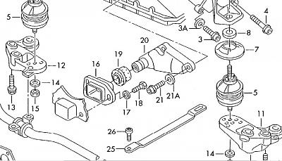

etka had this, but can anyone check if this is correct? and where do those pins go???
Old Sep 24, 2011 | 08:41 PM
badinstincts's Avatar
Joined: Mar 2007
Posts: 189
i changed the engine mounts and actually saw just a tiny bit of paint left, it was the arrow I made pointing to where the little stud/pin should be, the etka drawing is wrong, the drivers side mount should be 1 pin out towards the drivers side of the car... the studs/pins are pretty much aligned themselves when you attach the engine mount to the engine and they can only go 2 different ways, and I had that tiny bit of paint to tell me which way to go. yay. One of my old mounts the lower bolt was broken inside, it moves easily. the rubber on top was cracked all around. My transmission mounts looked good, but they moved around (by hand, squeezing one side or the other) much easier than the new mounts I got from fcp... I'll finally see how it drives on Tuesday I guess. Ohh and I think i stripped one of the transmission mount bolts, I didnt feel like looking up the torque specs and just tightened the first one as much as I could with a short socket wrench and I guess I screwed up the threading inside the mount. Ohh well, I'll see how that goes. It doesn't seem uber important, it still holds as it should, the bolt was still pretty tight...
