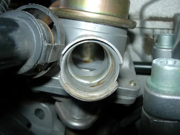

The combination valve (EGR Valve) is at the front of the engine. It looks like this.
Really the Vac lines are probably 100 times more likely to crack and fail especially on a car of that age. If they are old just order a 5 meter roll from www.ecstuning.com . I get the braided line-like OEM. It's easier to start diagnostics when you know the maintenance is up to date. otherwise it could be a ton of little nonsense creating one problem.
