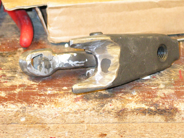

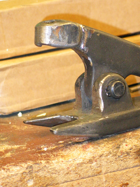

I had to buy a front end servicing kit to get the one ball joint tool and still had to make some major modifications to it to fit on the one joint. All of this to save me from not buying the VW tool which is around $250...

Here the tool I'm referring to... http://www.VAGLinks.com/Pics/TieRodEndTool_002.jpg, http://www.VAGLinks.com/Pics/TieRodEndTool_003.jpg& http://www.VAGLinks.com/Pics/TieRodEndTool_007.jpg,
