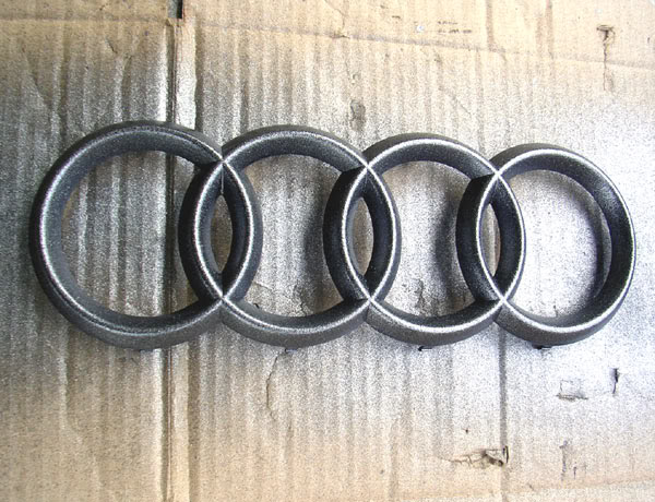

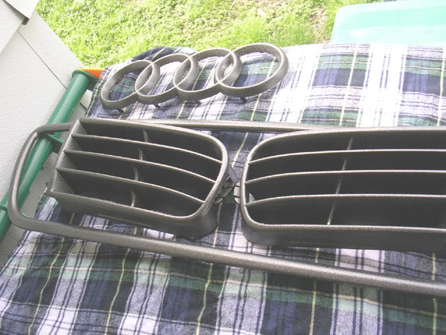

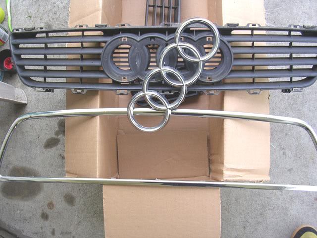

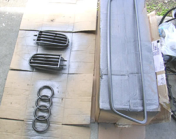

I did a little painting today.
The plastic grills were looking very weathered so I decided to give'm a fresh look. In the process, I decided to rid off the "aluminum" look on the circles and the main grill's edge.
Hopefully I didn't turn myself into a "ricer"

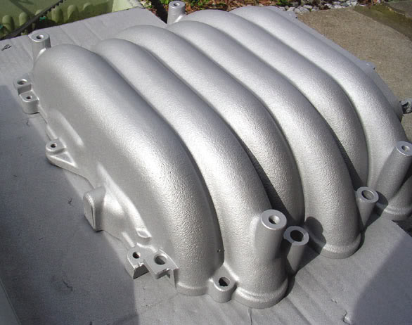

More painting:

First Coat:

Next is baking in the oven, as per instructions...LOL

Baking - so far so good; nothing is peeling off :
(I'll be starting on the second temperature - 400°F)

that superbond plastic paint suppose to be chip resistant.
at least that's the claim on the can, but of course nothing is bulletproof. if it happens, i can surely repaint it or touch it up.
anyway, i'm pretty sure the front will look much better than it was with the dulled out and weathered plastic.

As far as the "heat" goods, that's how they turned out after the last bake at 600°F
(I pulled the grill out on the porch to rid off the smoke inside the house):
While the manifold was more of a "raw" surface - so not real problems there, I was a bit concerned about the valve covers since they still had the old paint underneath - I didn't scrape it, I didn't remove it; I didn't even prep the covers beyond the cleaning they had previously!
No flaking and no peeling off after the baking. Is a good sign that the enamel is there to stay for a long time.
I was thinking "black" for the covers (initially), but they may look better in unison with the intake manifold once are all in the engine bay.
Plus: you can spot better oil leaks on "silver", rather than on black

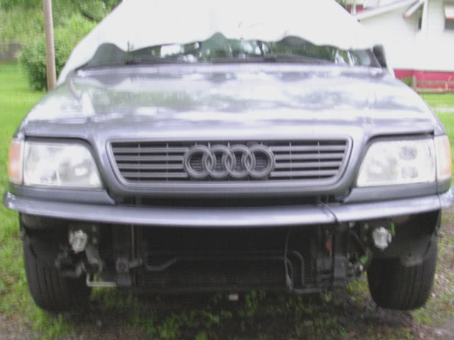

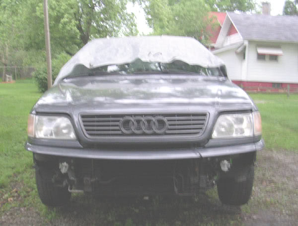

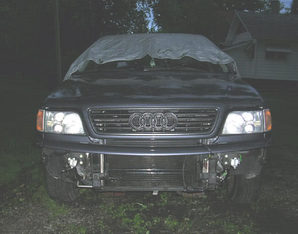

And this is how the painted grill "blends" with the car:
