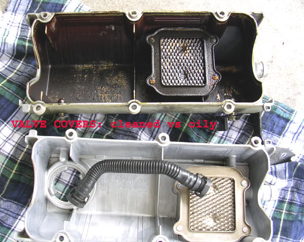

Jim, didn't you remember seeing them when I cleaned my covers?
By the way, my driver side bank's gasket (Victor Reinz...) started leaking a month or 1 1/2 month back. I don't know what caused it, by I drive daily with burnt oil smell and smoke from the leak. Two more weeks and I'll have time to pull the engine apart again...
Anyway, I agree about the design... even the Elantra's rocker cover has raised edges to house the gasket. Audi's design blows.
What type of bolts did you end up buying? Did you find the recessed head Allens or you ended up with regular hex head?
Tks.

Doh... I forgot I guess ...Mine where 100x worse than yours. Seriously. I scraped out the crud with a putty knife, and, since mine are plastic, there's alot of reinforcements inside to make cleaning it a PITA. I couldnt even see that there were filters till I started cleaning. Wierd the covers were so bad, but the cams/heads were clean as a whistle other than a little carmel color??...
Looking at yours, mine are different.. I have clips to remove the filters; and my rails are different - It looks like yours fit around the cover's lip. Mine fits into the lip. Wonder why the change?
I found the same bolts at the Farm Store (Ace). Allen head.

My Elantra has a groove/channel in the cover, I know what you're talking about. I had to change the gasket on that one last March and it never develped a leak.
On the Audi the leak started either because of the design, or the rubber didn't hug the lip tight from the beginning. The passenger side one has no leaks.
I'll check my Fastenal store for new Allen bolts.
P.S. - Plastic covers = Truth in Engineering
