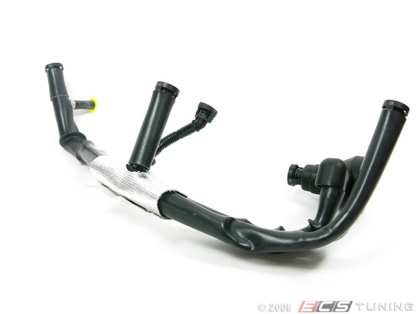

Im pretty sure this thing is clogged up and I want to replace it myself.... Took all covers off...Passengers side , driver side? I need a good pic , explanation, or diagram or all 3,....

If there is one its behind the motor, a little lower than the silver Y pipe. Most 2.7T's don't have one but they do have a large PCV hose assembly that looks like this.
You can get one at www.ecstuning.com for around $160.
