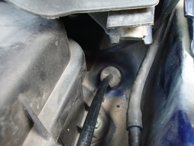

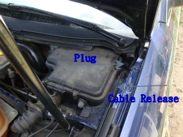

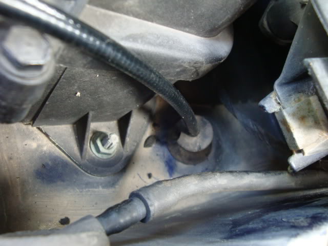

Hi All, been having the same problem with my 2001 A6 Quarto. But I think I might have found my problem anyway!
The cable for the Bonnet(Hood) release has a rubber plug where it passes through the body. Mine was pushed in so far I could see the floor inside! So persuading it with a pliers I pulled it out, firstly too far but that actually helped. I could see a groove where this plug sits wrapped around the body of the car so using a long flat screw driver I pushed it back into place.
I've added some photos so you can see what I am talking about.
Should have taken some photos while I had the plug pulled out but thought of it too late
Mines a left hand drive so the cable is on the left but as far as I know on a right hand drive the cable is on the right.
Hope it helps
