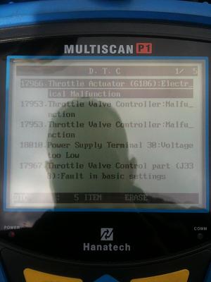

I have ordered the throttle body and accelerator pedal got them both cheap. I have checked for a spark which it is doing and also checked if the injectors are pulsing which they are. I the took the throttle body off and undid the clips on the side when it opened the seal had expanded and the components where full of oil where it had manage to leak in so fingers crossed this is the problem, but as i said before i thought it would of still started. I have uploaded a photo with all the faults any help would be grateful thanks.
Yup - sure sounds like the TB is shot plus that's what the codes say too. I'd replace the TB first and if that's all the problem is, just keep the accelerator pedal sender on the shelf in case you ever need to replace it too...

Replaced throttle body and accelerator pedal today. Once fitted turned ignition on for five minutes could actually here the noises from the throttle body, which before was not doing anything, after five minutes i turned ignition off and attempted to start the car which it started straight away :-) so i think it was down to just the throttle body, thanks to anyone that replied
