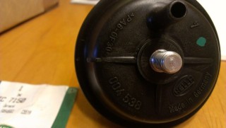

just wanted to pass this along:
Audi intake manifold bellows #077198327 ($400) is the same as Range Rover #ETC7150G ($72), minus the plastic arms of course. got mine from [url=http://www.roverparts.com]

what's even weirder is lamborgini uses the same ones at a lower cost than audi also.
Lamborghini DIAPHRAGM | 077907327A
