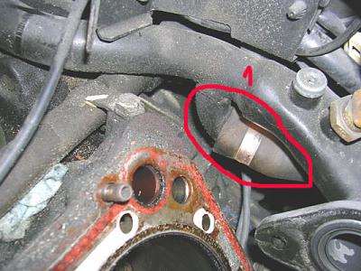

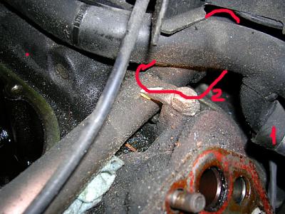

I just flushed my coolant on my 2000 a6 2.8 Quattro. The heater hose by the battery got really swollen. I want to replace both heater core hoses. I can't see where they connect to the engine. Has any one replaced these hoses?

I haven't replaced them, but one connects to the rear main line, and the second one (still in the back of the engine) to the line that goes to the water pump housing.
Probably you'll have to take off the airbox/manifold/throttle body to have a good access to the connecting points.

Maybe this helps better ;
Attached Thumbnails Need Help With Heater Core Hose Replace!-hc1.jpg   Need Help With Heater Core Hose Replace!-hc2.jpg
