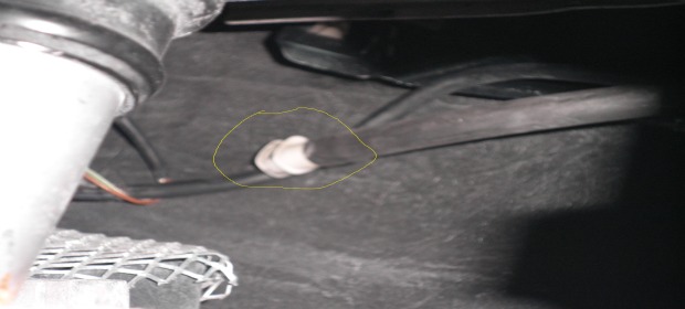

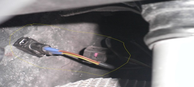

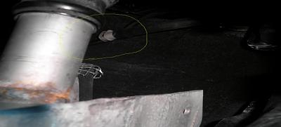

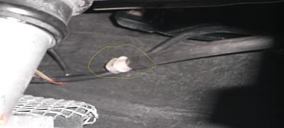

I purchased a 2000 A6 2.7 from an insurance auction and had a shop replace the front bumper cover that was missing. A few days ago I was replacing a bulb and looked down and noticed a hose that ran from the driver side of the car, under the fan and ended without being connected to anything, Pictures attached. Upon further inspection I noticed what I assume was what this hose was to be connected to on the driver side front end - picture attached ( white connector) . This seems logical, but the hoses do not reach each other. I dont know what the people did that owned this car before, but I love this car and want to put it in its rightful working order. Additionally I noticed what appears to be some sort of electrical connections that were not connected to anything- pictures attached as well. I know my abs brake light is on, I wonder if that is due to one of these things not being connected properly. The previous owner, in all their wannabe fast n furious wisdom placed spacers on the front wheels, complete with, get this, Bolts. You heard it ladies and gentlemen, bolts. Im talking bolts like the ones that stick out of frankenstein neck. Anyway, one problem at a time I guess. Anyone can take a look at these pics and give me and idea on what is what and how to fix it, i would appreciate it. Thanks. And Happy Holidays!

Well I am not seeing your pics but I beleive the hose you are talking about is the hose for the headlight washers it comes into the front bumper on the drivers side then runs across to the passenger side. cant help ya on the electrical as I do not see any pics to reference.

I agree with Padog...the hose appears to be the connection for your, "headlight washers" not, "headlight wipers". If you look on the front bumper cover, you should have small square shaped plugs mounted just below each headlight. The connection for this hose is accesible from inside the front driver's wheel well. You have to pull the plastic fender liner back to see the connection located inside the bumper cover, just below the driver's headlight.
The wire you see hanging may be an electrical connection for your foglights...or it cold be some other electrical connection that was missed by the shop that installed your front bumper.

The hose is definetly for the headlight washers (Audis just wash, they don't wipe). You will need a clip from the dealer. Or, save yourself some grief and leave it unhooked and the other end crimped. That hose is a known leaker.

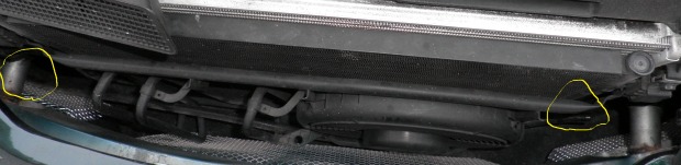

The electrical connections look like outside air temperature sensor and foglight. The OATS is on a crossbar in front of the radiator.
