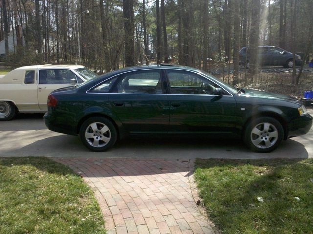

Nice to meet you, I'm Ben. Recently turned 17 and this is my second car; the first is visible in a pic or two below. 7MPG plus no heat, no AC, no radio, no wipers made for kind of a crappy driving experience.

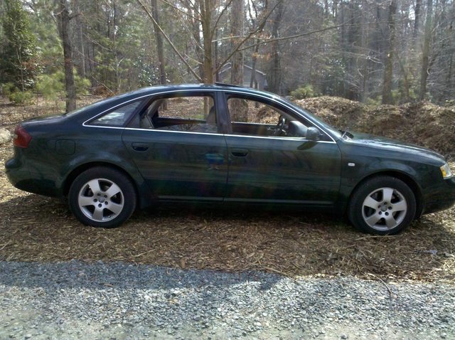

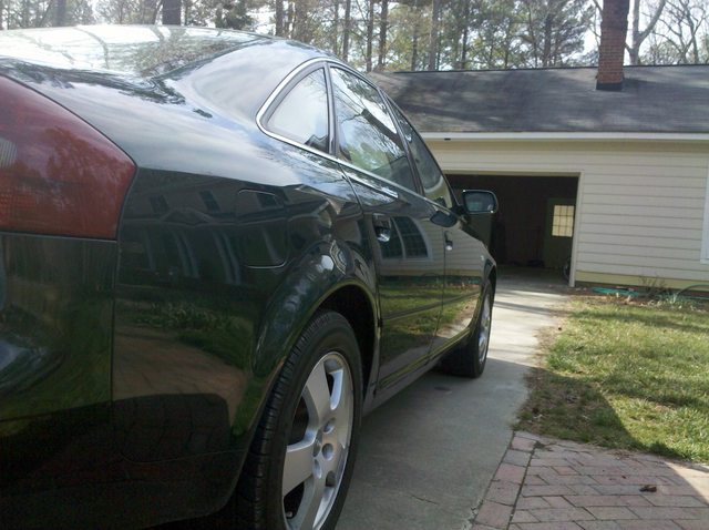

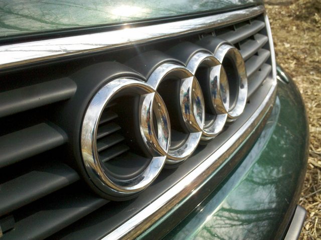

Sorry this is so long-winded. On to the pics and I genuinely appreciate any help y'all have!
