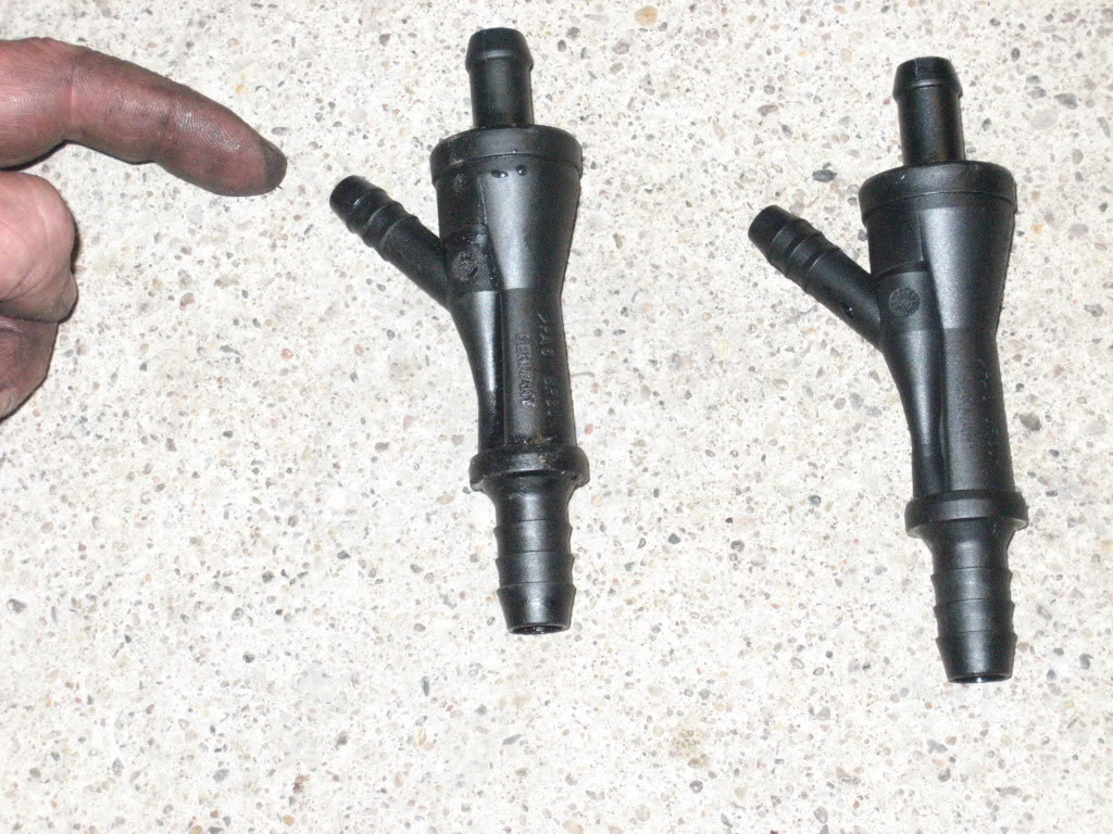

Also bought and changed out the brittle, broken, PITA plastic corrugated crank vent lines and the check valve AND the 'injector pump (the plastic "Y"). Turns out, one of the 3 legs was plugged (new flowed, old did NOT). This may have been the (main/only?) cause for my oil leaks (smoke driver and passenger side when dripping on exhaust/header).
Now, can't figure out where the 3rd leg of the Y goes. The straight out (12 o'clock" I have. What connects to the 1 o'clock leg of the 'pump' (the one going out on an angle; finger pointing (was also the one that was plugged on the old pump).

Unless someone else gets you the answer I will take a look tomorrow. My car is at my shop. I would say to put the same hose back on the new one as you took off the old one but that would be the snarky answer. It's my recollection that the one you are pointing to faces the firewall.
Yes, it branches off, direction towards firewall.
Just don't seem to find a loose hose hanging around in that area that goes on there (didn't take pic of the area before ripping out; duh!).
