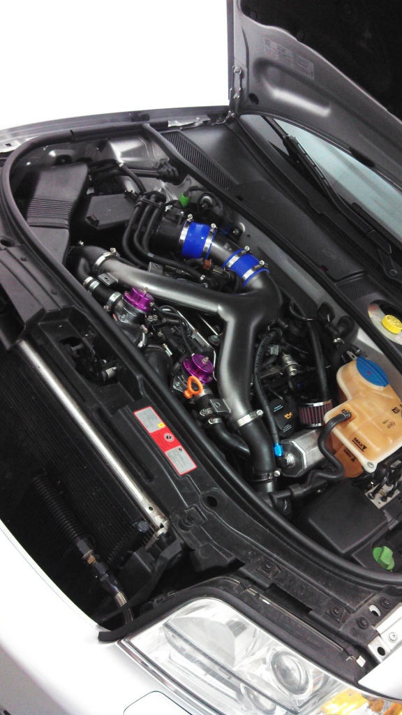

Here's some pics of my setup on my c5 tip 2.7

I like this what all did you do and how much did it run you?

Summit tank $40
K&n vent filter $20
Grommet $2
1/4"x-8an fittings x2 $5
1/4"x-8an 90 fitting $6
-8 straight hose ends x5 $20
-8 weld bungs on the valve covers and valley plate x3 $12
-8 90 hose end $20
10 ft earls push lock hose $40
$165 total
Now if you don't want to pull the intake manifold to remove the valley plate you can use -10an hose as it slips right over and clamps on the factory nipples.I've successfully done this on another guys car.

Very spiffy! Won't fly with the California emissions, but looks cool. Where did you tie the breather hose to?
