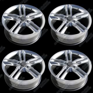

but a friend send a pictures of another rims, i want to know the part number for these and will this fit my car, a 02 Audi A6, 3.0L FWD
i wanted to know if these fit and if they fit what tire size should i put, sorry for the nubby questions... info i do know about these is
Size: 19 X 8.0
Bolt pattern 5 X 112
Offset of 35
central bore 66.45

I found those rims but in size 8.5x19 with offset 48. I wish my listings would let me look by rim size, but I have to look at the different series A4-A5-A6-A7-A8 TT etc, and then click wheels and check sizes. So it takes a while and unless I missed it, I don't see that wheel in that size and offset. Can you get the part number off the back of those rims in your picture?
As to fitment, I'm no expert on this, but you'll be going from 16's to 19's, much taller, and one inch wider so that is tough to say if it will fit or not. I'd be willing to bet it would have interference from tire to wheel liner or maybe elsewhere else at some point towards hitting the bump stops on the steering system.
If those rims are from a 2012 A6, which I did check, that car changed the bore size of the rim. It's good you measured that too.
Here is some fitment issues we did find with the wheels from new vehicles. When trying to fit our customers winter tire and rims from 2009 and older cars to their new vehicles we found:
2010 and newer A8, 2012 and newer A6 cars have larger center hubs. So older wheels won't fit since their center bores are too small. But you can use those newer wheels on older cars only if you can find the concentric hub to fit inside to center it up. We also found 2009 and newer A4's have larger hubs also.
