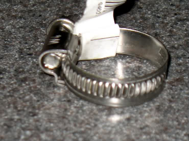

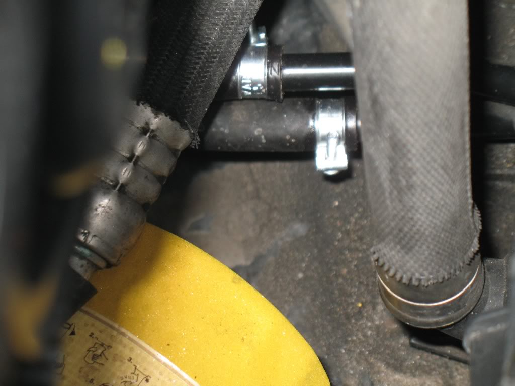

The clamps on top of the pump i changed with SS non - perf and then the lines that are attached to the cooler (squigly line in front of the radiator) I replaced with fuel line clamps I got at advance. Also used the fuel line clamps on the resevoir lines.
Lower line clamps/ next to oil filter

Fuel line clamp
top of the pump clamps
SS non-perforated clamp
