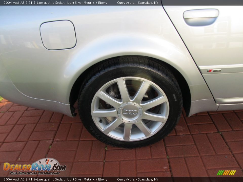

Got any photos? It could be the doing of the previous owner.
The main badge would be the ones on the rear doors:
And I think the trunk spoiler and sharkfin antenna came standard on all s-lines
