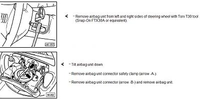

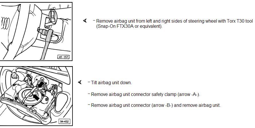

I did this at least 10 times on my S6. It is easy. First, turn off the car and wait 20 minutes. The Airbag system has a capacitor to store charge so that the bags will still go off if power is cut in an accident. 20 minutes is more than enough. Then get the T30 and a ratchet wrench. The torque may not be much but could never loosen them with a screwdriver type Torx. Once you get the screws out pull off the airbag and unplug it from the wheel.
Next, take off the top and bottom plastic covers that cover the steering column. There are two connectors that go to the clock spring. One for the airbag and one for the horn. Disconnect these.
Now mark the orientation of the steering wheel relative to the steering column bolt so that you put it back on straight!
You will need a LARGE metric socket to remove the steering wheel. I do not remember the size but it is in the Bentley. Remove the nut for the steering wheel and take it off carefully. Make sure you do not damage the clock spring which I believe comes off with the wheel.
