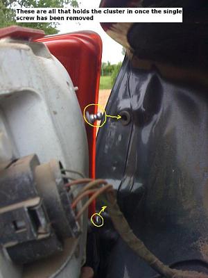

  • In the boot, remove the side access panel
  • Just inside the reveal, facing the back of the car is a circular plastic cap. Remove it.
  • This reveals a screw which can be removed with a suitable size socket. I think about M14, but I got away with a .5".

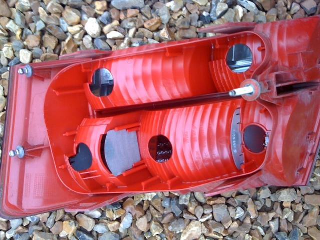

  • The entire light cluster will now come off, but it needs some force as there are push fittings that I don't know the name of. Anyway, the force is directly from front to back of your car. I had to carefully use a flat-bladed screwdriver to apply force from the front of the light cluster as I couldn't get a decent purchase anywhere else.

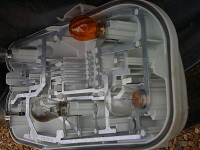

  • Once that's out, undo the clips that connect the white plastic housing to the red plastic outer and the bulbs are revealed.
  • replace the bulb and do the above in reverse to reassemble.
