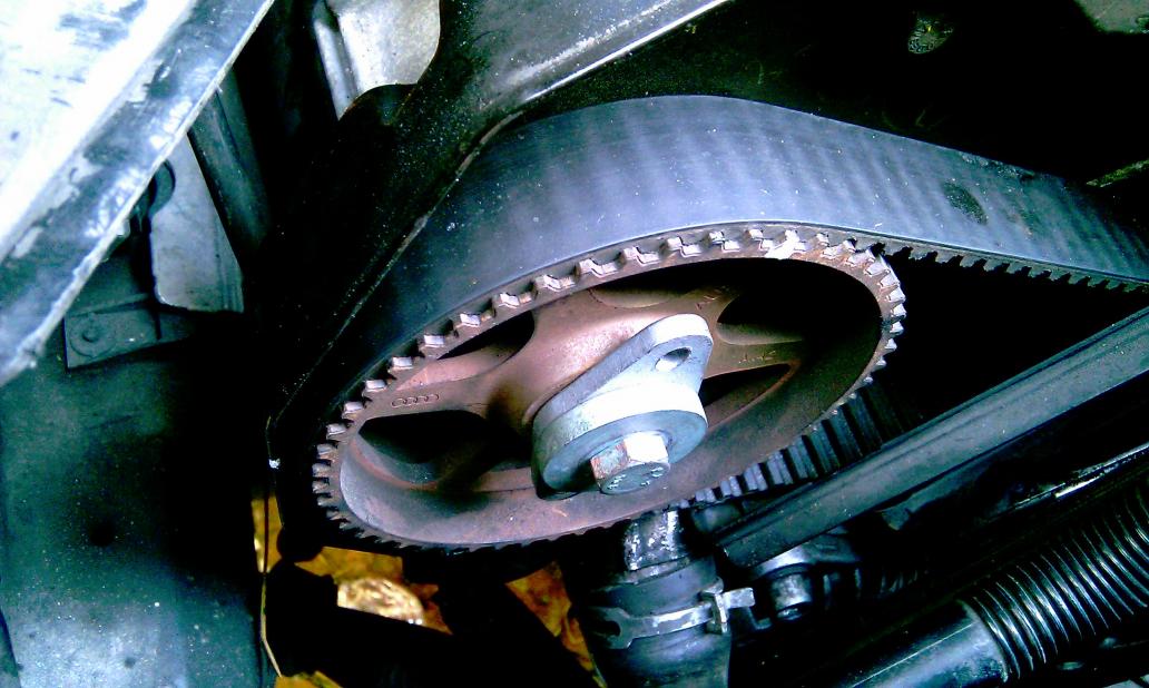

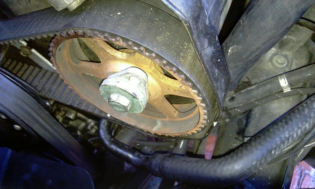

Blah the belt jumped upon cranking grrr. I shut it off immediately so seems no harm done. Well ill throw u some pics Seems awkward to me, I tightened the belt and aligned the markings up perfectly but it seems it still jumped some how. I popped the TB covers n it is still tight, but the markings are way off and you can tell the cams are not aligned.
Old Dec 16, 2010 | 12:43 PM
  #18
jzstuggie's Avatar
Joined: Jan 2008
Posts: 103
Left And Right from front view of the car. White markings on the cams are shown, i dont even think the "wings" are in the same correlating position.

If markings are off, then your timing is off for sure. You need to align everything, including the crank. When you aligned the belt the first time, did you make sure to align the crank?
Old Dec 17, 2010 | 01:24 PM
  #20
jzstuggie's Avatar
Joined: Jan 2008
Posts: 103
Actually no. Honestly I just went by the markings on the sides on the cams. I figured since i didnt completely take the belt off it would just fall back into place. I should have known better.
