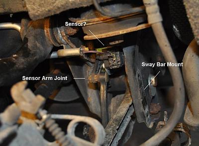

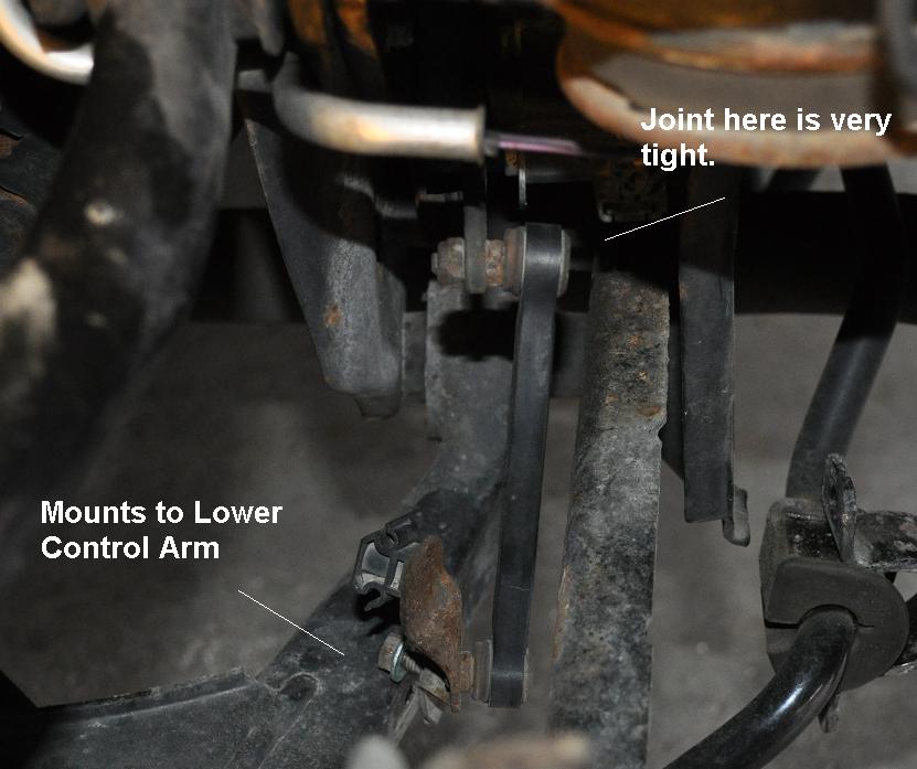

Default What is the sensor attached to rear driver side lower control arm?
Thanks Bob. I only managed to screw it down about a half inch from the top tread. I did not have a deep socket and I could not get the springs to compress any more. It will have to do and hopefully the nylon lock should hold the nut.
BTW as I was loosening the rear lower control arm on the driver's side there was a sensor of sorts attached to the arm. There isn't one on the passenger side. It looked like a level sensor and is mounted on the chassis with a two piece plastic arm that is jointed and bolted to the lower control arm. The sensor arm is really stiff and tight. If you know what it is, is the arm supposed to move freely? The picture is not very clear because the camera won't auto focus in the tight space.

Default Looks like it might be the ride height sensor
I was searching the rest of the forum and googled the WWW and there are some postings that described such a sensor as the ride height sensor that controls the level of the headlights. I don't have the Allroad, just an A6 Avanat, so this does not adjust the suspension. Could someone who is familiar with such a sensor confirm or comment? I need to know if the joint for this sensor, as marked in my pics above, should be moving freely. It is very tight right now and I don't know if it is corrosion or if it was over tightened during a maint service. Thanks.

It's the headlight level ("range" in Audispeak) sensor, or one of two, to be precise. Clean up the contacts while you are in there.

Thanks Bob. I will loosen it up and put some anti-seize so that it will continue to move freely.
