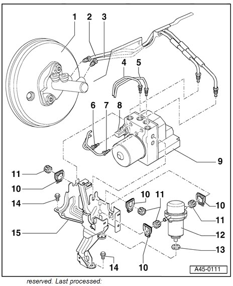

However since that signal comes up under ABS I would imagine that your codes are related to one another. Look for that brake pressure sensor and see if it's wire got pinched from all the work lately. Whenever something goes wrong right after I did a lot of work on it. It usually ends up being something I moved or hit.
The sensor is No. 8, so basically it's right where you put your tools when working on the engine.
