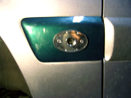

One of my Audi oval insignias fell off some months back and since I have time on hand I'm thinking to retrofit both side trim pieces with side marker lights.
I would just run the wires straight into the corner turn signals.

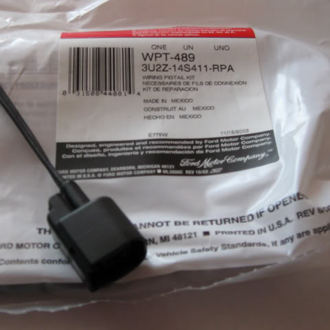

P.S. I came across some other OEM oval marker for Mercury Mountaineers - part # 1L2Z13368BA - which seems to fit even better the oval recess (they appear to be smaller than the ones off Ebay), but I'm tired of waiting and the local Ford/Mercury dealers have none in stock so I can take a good look at its size. They're about $ 15-20 /piece (depending where you buy it), but since I have no idea how can be mounted (I don't see any screw holes on it) I gave up the idea.
1L2Z-13368-BA is the part number (about $12 each), and the WPT-489 wire/pigtail assembly (about $20)

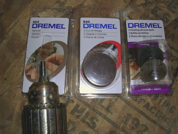

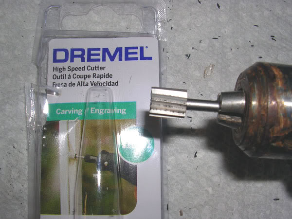

I don't have a Dremel, but I bought a few pieces I thought will help me do the cutting especially. Had to get a "mandrel" that mounts in the drill and holds the various attachments via a screw; cutting wheels; a high speed toothed cutter (for carving); some buffing wheels; and some diamond "points".

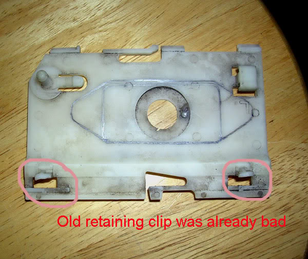

At least the driver side trim (with which I started) - the one without the Audi oval insignia - was already in bad shape as some retaining clips were broken. I lost the oval insignia because it has been glued..

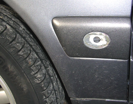

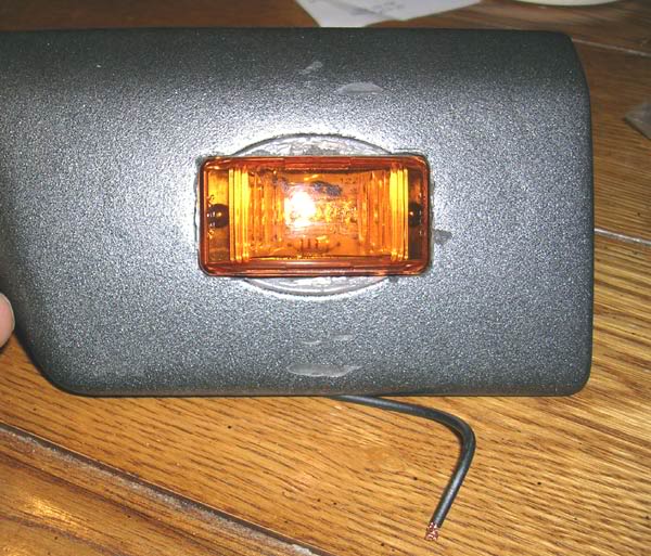

Since I had in mind to replace the trim pieces anyway, I sort of had a "freebie shot" at it with a LED generic marker from WalMart:

Since it came out like crap (beyond even a "ricer" look...), I decided to look more for oval ones, and luckily I came across the EBay ones.

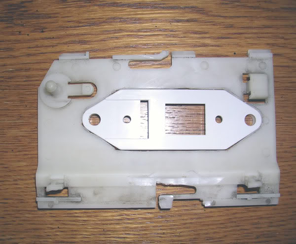

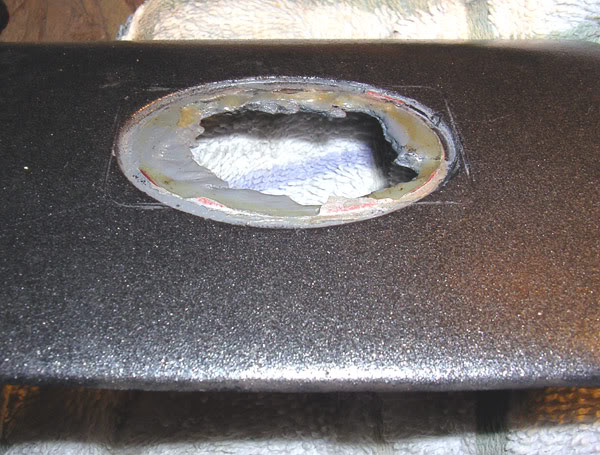

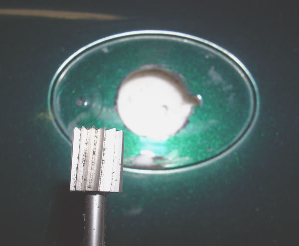

So today, after the trim mounting clips came from ECS Tuning, I started cutting the trims; at first with a larger drill bit, then with the Dremel carving wheel
And through the new retaining clip:

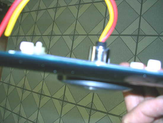

The rubber seal helps it stay flush with the trim:
Two holes for the bolts:

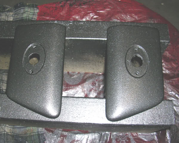

And lastly for today, I painted the trims with the same dark grey all the others on the car have:
