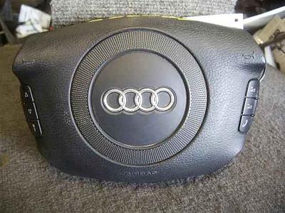

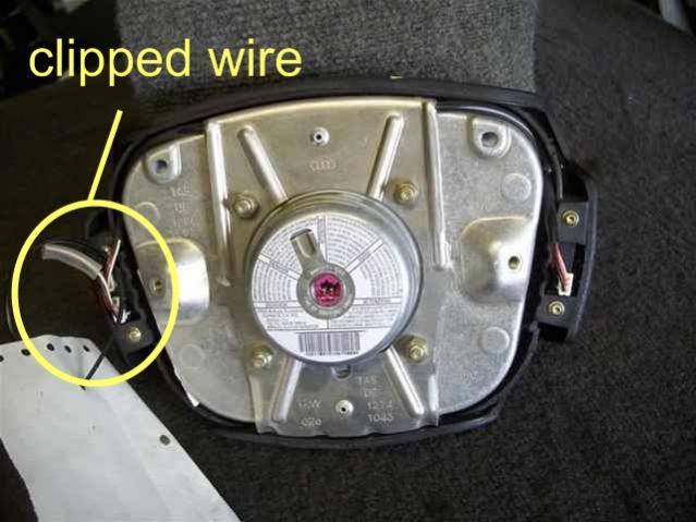

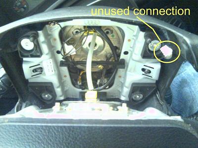

here are some pics:
the first one shows my steering wheel the loos plug is circled.(sorry its kinda bleached out, i took it w my phone)
the second one is of the one from ebay, notice the clipped wire circled, it looks the same as the unused wire in my wheel.
the third is a pic of the front of the ebay airbag, for reference.
Thanks!
btw, how do you embed pics directly into the post, instead of attaching them.
Attached Thumbnails Steering Wheel Controls 98-2000-steering-wheel.jpg   Steering Wheel Controls 98-2000-ebay-airbag.jpg   Steering Wheel Controls 98-2000-new-airbag.jpg

Well worth a try.

Well, I was able to find a really cheap set of airbags with driver controls. So I was dismantling the existing airbag and saw that the plug in the back of the air bags was different, the pins were the same so it fit but the plug itself was different.
Also the blast pack on the back of the airbag was thicker so a cross brace in the steering would not be able to be used (no big deal). Well I plugged the cable that was in my steering wheel into the airbag w/controls and...nothing. Well i started taking stuff apart and what i can figure out is that, hx gasser you're right i need a new clock spring. The dumb thing is, why does the steering wheel electrical board have(my car has steering wheel heat) only the power input for the heat but the OUTPUT for both the controls and heat?
The clock spring also only has a plug for the heat. but that makes sense, more money and all. Just weird that they would install the controls cable in the wheel at all...just letting people know, if you want to install the controls you will have to make sure your wheel has all the correct plugs and to get a clock spring with all the things needed.
