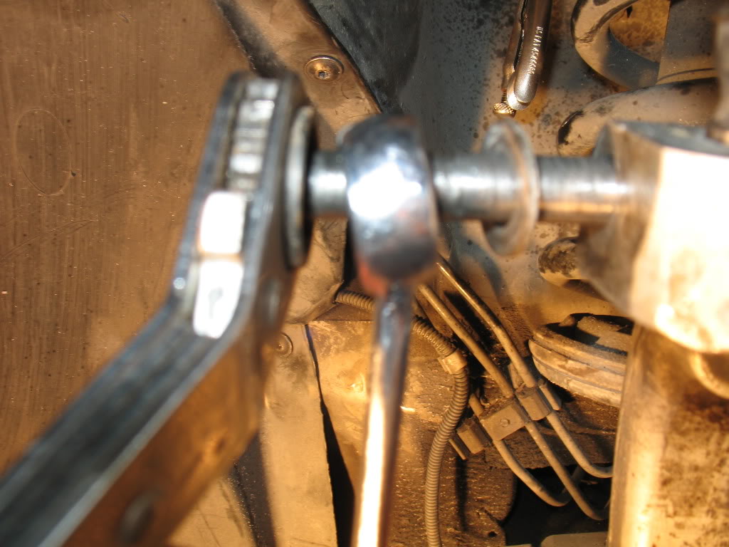

This is the bolt that gave me trouble. Spray it and spin it before cutting it. Bob Martin mentioned that the bolts on the cars that see road salt are a PITA to remove. So be sure to use antisieze on reassembly!!!
It is the forward upper. The bolt slides forward but hits the wheel well making it impossible to remove with out removing the strut.I cut the head off with a sawzall. be sure you place a small vise grip on the bolt head side your cutting so the blade does not hit the perch. To reinstall take a long prybar 3' push it through the spring so you catch both sides and lift. It will **** the spring so you have enough room to push it in.
I was sitting on a stool and put the bar on my shoulder and slid the bolt in.

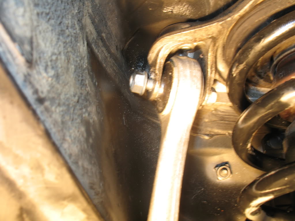

Before
After, note bolt is in opposite direction

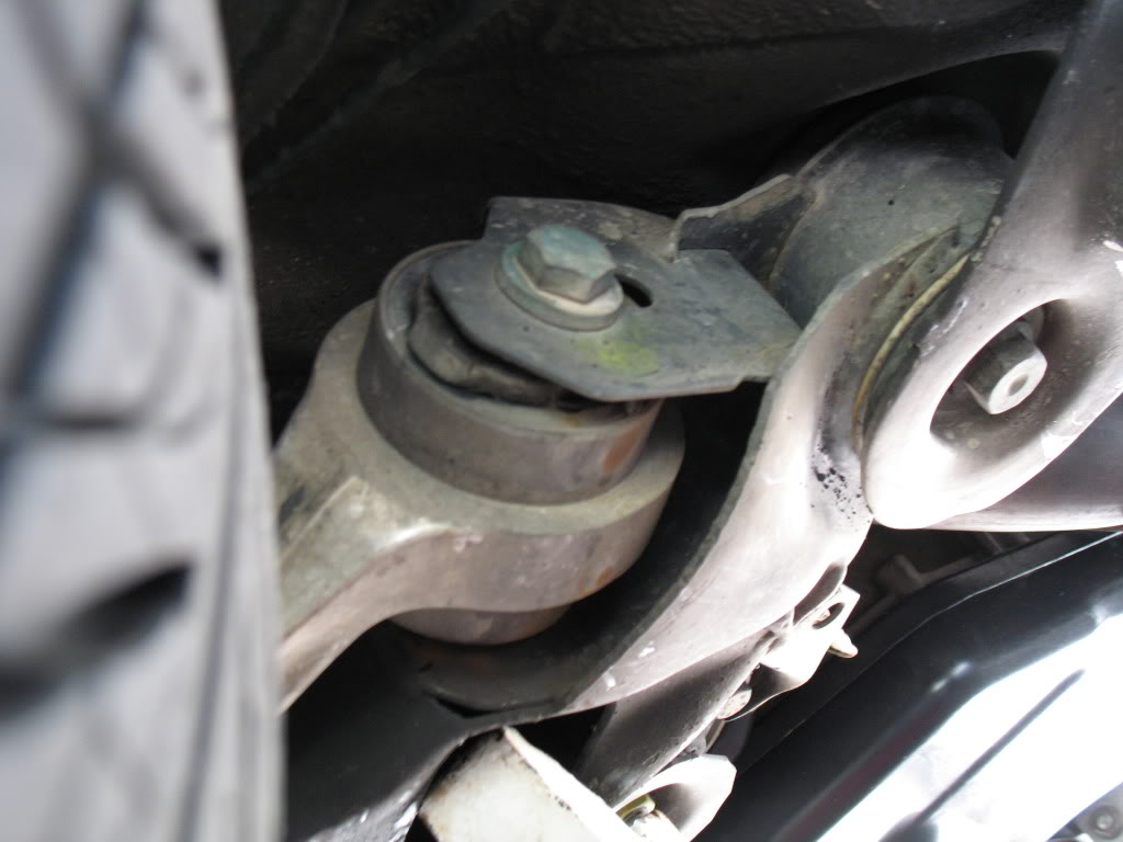

Here is where I found the worst bushing. This is the rear lower mount where it is attached to the sub frame. When I was moving the housing around I could hear it creaking.
I was able to move the bushing by hand.

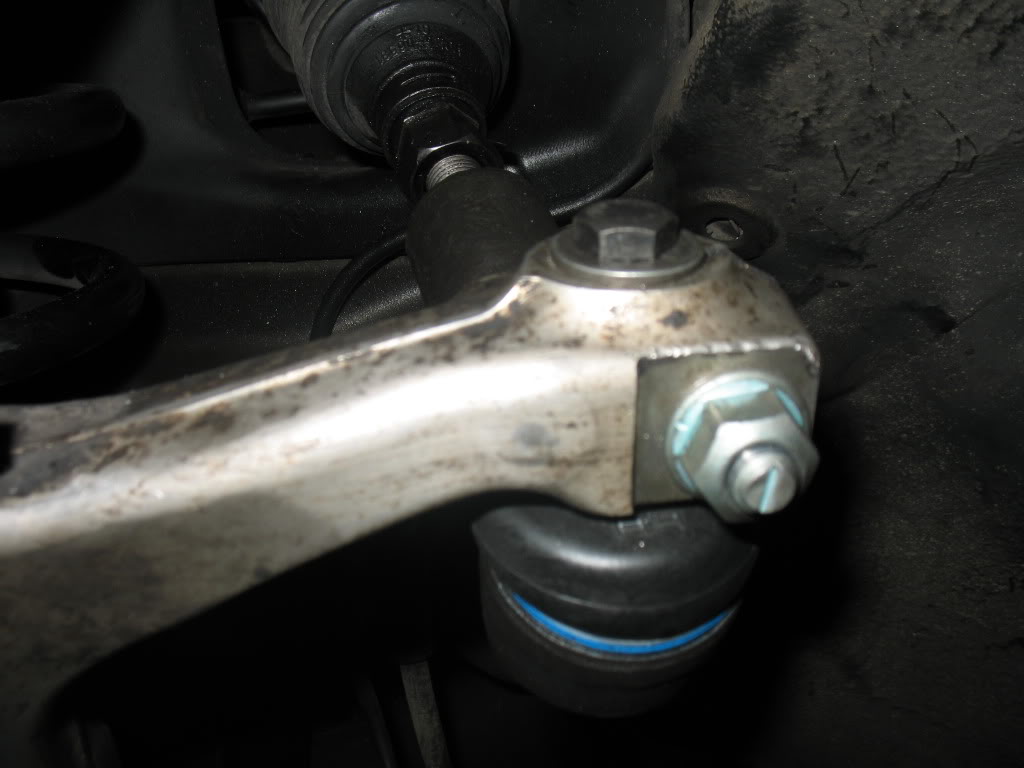

The uppers were not in good shape either. They did not have any play but the bushings were cracked.
You can see a crack here

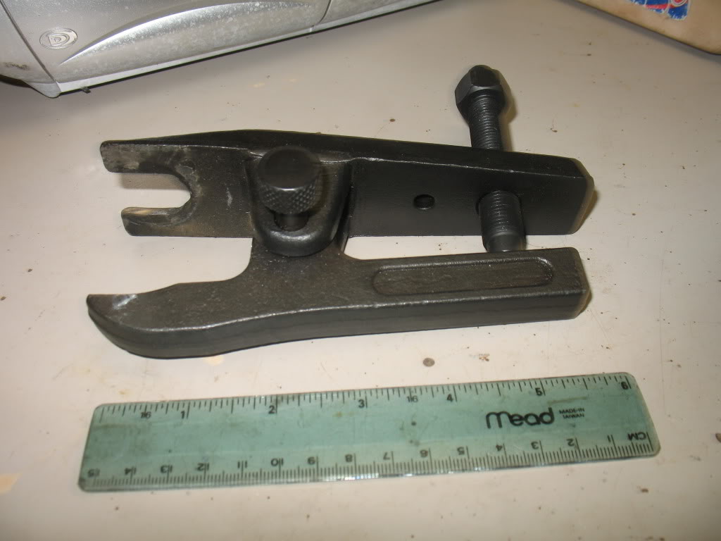

This is the ball joint remover I bought from harbor freight
Pretty nice for $20, I needed to widen the opening a little with a wizzer. You tighten it and smack the end of the bolt with a hammer as you go, like a puller. Then Bang out she pops.

BOB, this is all I have to do to get my bolts out. I place a wrench behind the head and push while turning. I deserve at least that much though this car is effin killing me. If my bolts were corroded on top of the problems I set it a blaze for sure.
Before

Lastly, I'll bet your rear lower control are was the root cause of your wobble. The bushings need to be tight and should not move in your hand like that. Replacing bushings only is a waste of time since the ball joints can't be replaced and are also prone to fail. My car has 90k, so time to replace the normal wear items anyway. Feels and rides like a new car again! Good luck with yours.

I think it was a combination of the rear lower and the uppers. The rubber was just really weak. I think I experience some different problems do to the constant heat than if I was up north. Seems like all of my rubber parts have failed. On the up side my bolts come right out.

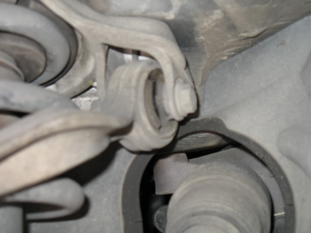

You may have the correct front lower control arms. The newer designs have a larger ball joint housing than the originals, so if your problem was not being able to get the ball joint stud in the steering knuckle without it hitting the driveshaft, I ran into the same problem. You have to jockey the steering around until you find the sweet spot and then tap on the ball joint housing with a hammer to get it into the steering knuckle. Both of mine only took one small tap with a hammer to get them past the driveshaft, I just don't know how they will come out next time!

Safe to say it is a control arm issue. If you are repairing this issue I would suggest replacing all of the arms and tie rod ends. If your on a budget I would start with the rear lowers, the bushing in those was the most played out. Then the uppers. I haven't done the front lowers yet because I'm waiting for the correct ones, so it wasn't them.
