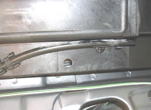

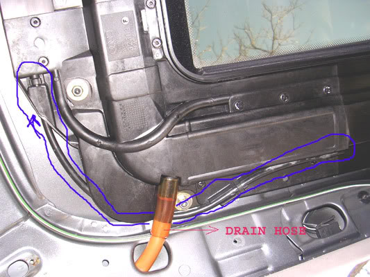

so it was indeed the first hunch.
NH, as I was reading your post, two similar tubes/hoses (however, those are all-black) came to my mind instantly. I noticed them on both sides of the sunroof tracks.
Bob, NH, you guys are priceless® !
Thanks much.
Thanks much.
These are for water drainage.
I don't think we talk about the same hoses, Zippy.
You can actually see the drainage hoses in my other thread, "Sunroof Leak", where I posted pics of them, all 4.
I am talking about a small hose that's on both sides of the sunroof housing tracks, and are sort of "riveted" in place. I will take pics to show exactly what I'm talking about. Those two have an open end.
