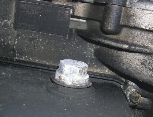

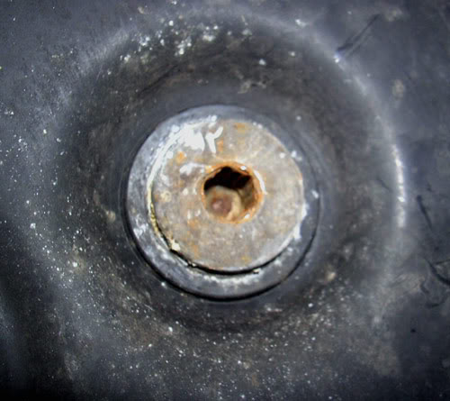

The drain plug is a stupid hex size : not 1/4 - too big, not 7/32 - too small, not 7/16 - too big, not 6 - too small or 7 - too big, metric.
I filed a 1/4 size one, but it ended twisting like a toothpick, even though I used the PBlaster lubricant several times. Decided to stop guessing or messing with the darn thing, so I drained whatever came out off the fill plug - actually it came A LOT... and just lowered carefully the pan.

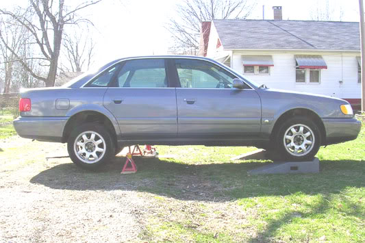

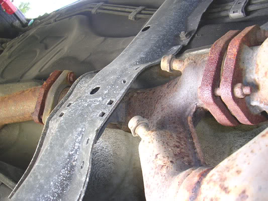

I tried to get the car on an as level as possible plane ...via eye-o-meter. Since I don't have the "goods" (garage with concrete level floor; higher lifting jacks _ stands; etc), I had to improvise.
Some write-ups I came across hail to have the car with all the wheels off the ground. Well, good for them...
As I hope I will not anger the frail and sensitive Audi "gods", this was the best I could come up with:

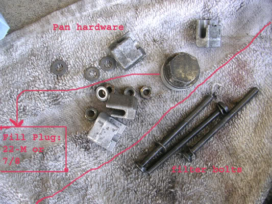

Once the car was up, I had to run to O'Reillys to look (as said previously) for a suitable size of an Allen wrench, but no available size fits the damn plug. I already commented on it... As far as the fill plug is concerned, I suppose I stink anymore at sizing by eye a big metric bolt...I said 19, but the plug is actually 22-M, or 7/8... It turned out to be a worthless trip to the parts store...

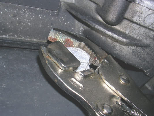

As soon as I returned from the store, I dove into dismounting the pan. Since I couldn't get the drain plug off, I just removed the fill plug with a pair of locking pliers...
(today I got a 7/8 crescent wrench from a friend to ease the fastening)

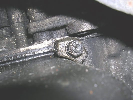

The pan is secured at the corners via 4 10-metric nuts and some clamps that suppose to provide even pressure at all corners.
I couldn't tell for sure if the gasket slowly leaked overtime, or if the greasy sludge build-up on the pan was a consequence of a motor oil leak somewhere and sprayed toward the rear... However, this greasy side was facing the rear, so I wouldn't see how motor oil gunk would build-up there.
With fluid still in the pan, I had to hold it with one hand and unscrew the nuts with the other. As the nuts came off, the clamps just fell to the ground. I held the pan and I lowered it carefully.

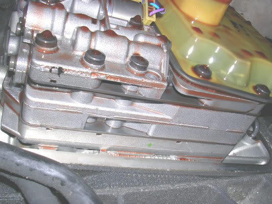

Familiar view for some - the pan is off:

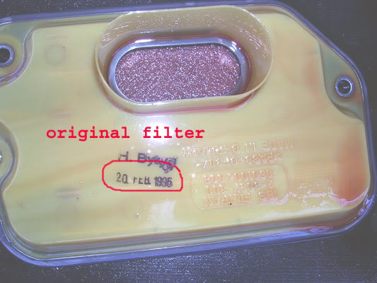

The filter is fastened via three long bolts, Torx-27 head. The filter in my tranny was the original one - 1995.

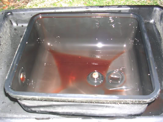

Here's the pan, emptied - actually I didn't find excess sludge or to much of metal shavings on the magnet

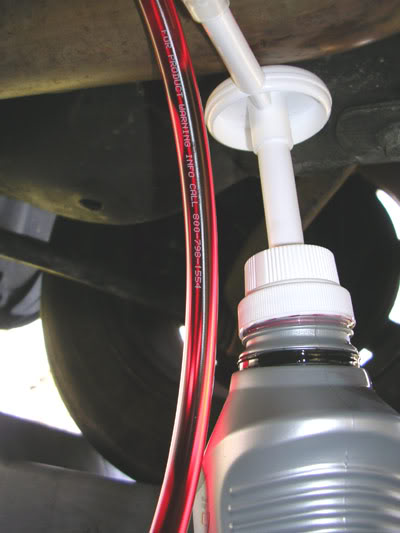

The supplies needed: I got the ATF from Blaufernungen, as a "Fluid change Kit" - they included only 4 quarts and I think I came up short a half of a quart which I'll add later on... So much for "professionals"...
The hand pump was a separate item from them - about $ 13.
The filter, its o-ring gasket, and the pan gasket were supplied by ArizonaAutohaus.

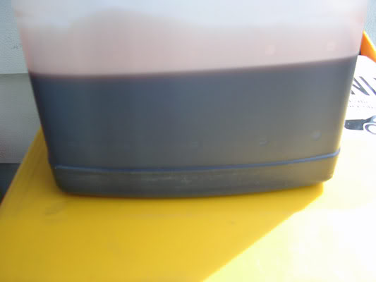

Nice looking fresh fluid:
And the old fluid - no burnt smell, but pretty dark looking
George, what I did was to leave it overnight to drip as much as possible (well, I was forced too - too lazy to work in the dark; plus it was already cool by 8 pm).

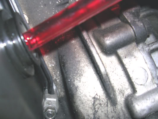

When I started filling her up, about 2 1/2 quarts went in before started dribbling. I screwed in the plug, hand-tight and started the car. As soon as I started it, you could tell it needed more....it had sort of a whining groan...
Got under and pumped about 1 more quart (so 3 1/2 quarts by now) until started dribbling again...The whining groan disappeared gradully, as I would pump. I fastened the plug again by hand and hopped in the car. Got the selector through all the gears for about 10 secs each, and then got back under the car.
I pumped the rest of the last quart and closed her up. I bet it would have taken another half more before being up to level. Whenever you'll change yours, please don't buy any BS kit from "trusted professionals" like Blaufernungen... Buy 5 quarts, or even 6 to be on the safe side.
Anyway, by the time I finished pumping that last half quart, and tightened the plug, I heard the rad fan kicking in... So about 15 minutes the whole shebang to reach that "adequate Bentley" temperature ...

I bet is a 6.5 mm, but I couldn't find one. As I said, 6 is loose in the hole, not catching a damn thing, while 7 doesn't fit in the hole.
Same thing with the "inch" sizes: 1/4 doesn't fit, yet the next one in all the sets sold - 7/32 - is loose.
Great engineering, indeed. Good thing that afterward they switched plugs to Torx or larger and even sizes unlike this one, with its size resembling a cow's dung on the pavement of a nice citadine park...

http://en.wikipedia.org/wiki/Polydrive
well, it is hard to tell with the rust on some of the walls.
Also, I never seen a polydrive pattern upclose, but shouldn't the corner grooves be more accentuated than in my pic?
Anyway, is not a big deal. the pan is not too heavy to hold it with one hand while unscrewing the last nut. I lowered mine without any spilling trouble. One good thing coming out of it though: no chance of leaking from the drain hole
For the future, I may look around for a diff plug type or....just forget about it.
