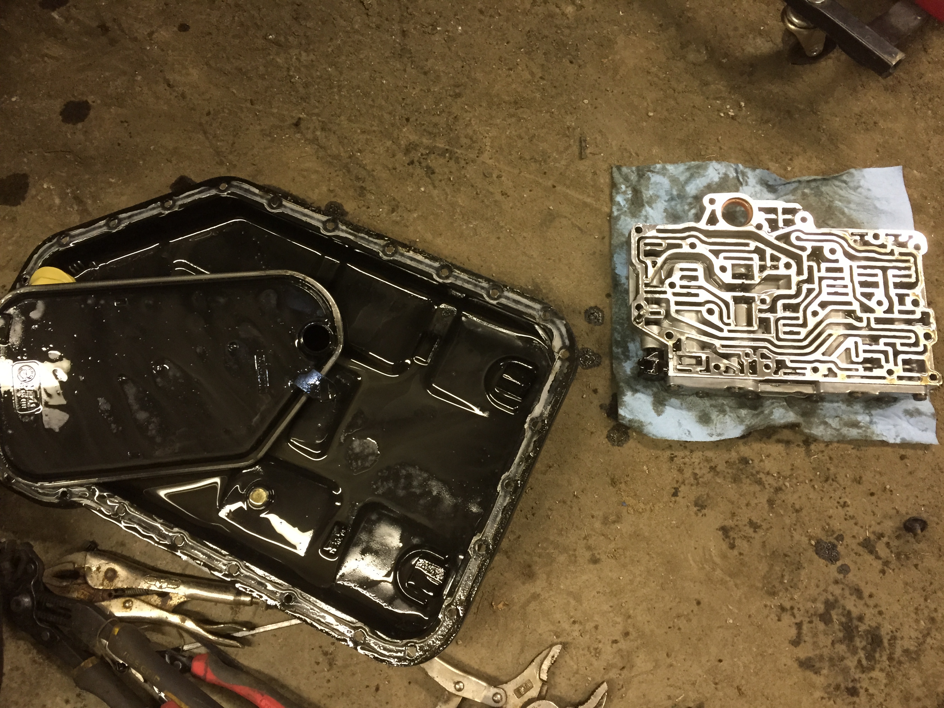

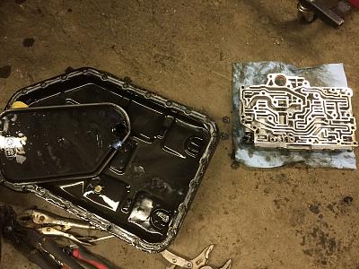

I just had a very similar issue with my 1999 A6 Avant. It was difficult to shift gears, but the car drove fine, and then when I went to shift into park, something popped, the shifter felt normal again, but the car wouldn't move in any gear. It also didn't want to shift into park. When I dropped the transmission pan, I found that the dog on the shift linkage had somehow popped loose from where it engages with the spool valve and it ended up behind the attachment point (See the attached photo).
I had just finished swapping in a new transmission, but I didn't want to take a chance on anything in the shift linkage assembly being bent, so I took the valve body out of the old one and exchanged it with the damaged one. Once I put the pan back on and put all of the fluid back in, it shifted great and has been working fine ever since.
