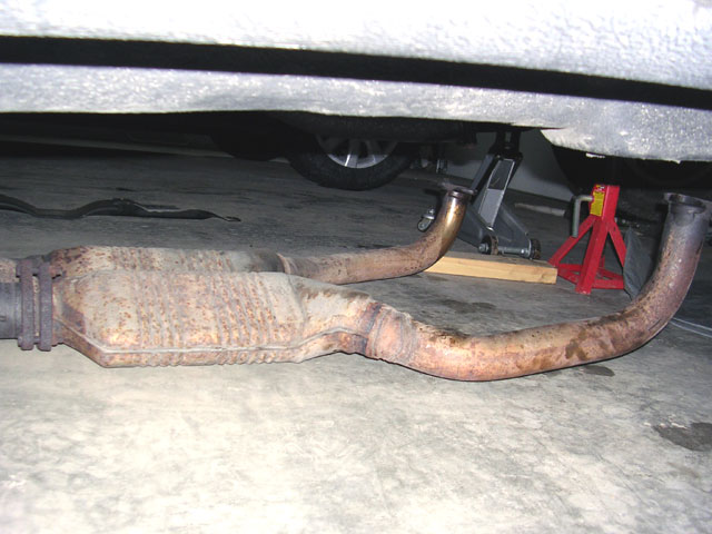

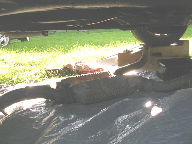

Oh, on mine I can take the cats out with closed eyes Already dropped them in two different occasions. I personally remove the crossmember - 10 bolts (is that what you call the subframe?), getting it completely out of the way.
To get to the top 2 bellhousing bolts, I removed the mounts from and lowered the trans a few inches. They were still by far the hardest ones to get to.
Yeah, I can't really picture it in my mind since I would assume that lowering the tranny while the bolts are fastened would put strain on'em and also make it hard to unbolt - but I'll figure it out when I'll get down to business.
Thanks. I'll keep watching the thread.
