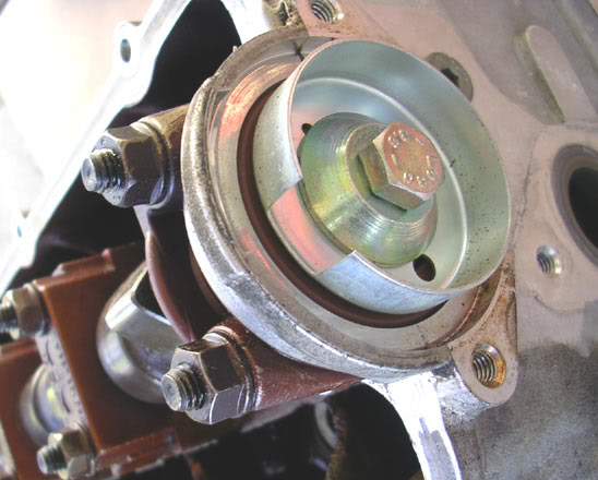

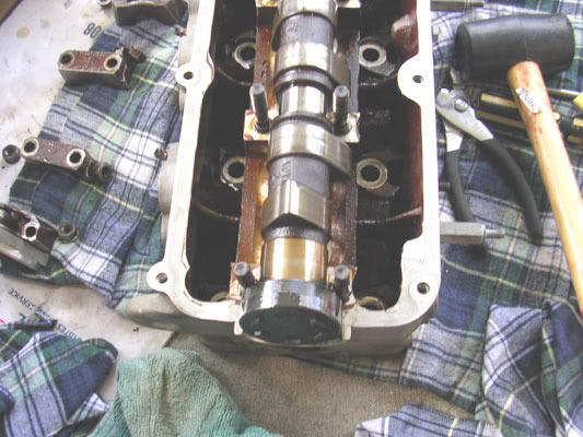

Chefro -- getting the valve covers off my car was easy. But I seem to be weeping oil from the bottom of the plastic cam plug which faces the firewall(passenger side) and at the bottom of the Hall sensor (driver side). How do I remove the plastic cap w/o ring (passenger side)? Is removing the Hall sensor (driver side) to keep it from weeping likely to be a tough job for a shadetree mechanic like me? Maybe I better just replace the valve cover gasket and hope for the best. But if it's no big deal top go the extra mile while I'm in there -- I'll go for it. Thanks in advance.
** Replacing the cam plug on mine -passenger side as you said, was actually easy in my case because I had both heads pulled out.
What you can do - since you have the covers off anyway- is to loosen up the two nuts on that last cam bearing, and try to tap the bearing gently upward on both sides with a rubber mallet to loosen it up, and then you should be able to pick the plug easily. Replace with the new one (coat it with a thin film of fresh oil), and torque back the bearing nuts to 15 ft lb.
If you are affraid to do so, then you probably have the following three options:
a) use a couple of metal sheet screws, drill them carefully on opposite sides, and then try to pull it out via the two screws
b) could use a very sharp pick tool and try it that way.
c) could use two needle-nose pliers and try to pull it out via two of the raised grooves you see on the plug's exposed side.
Some people claim that they're able to extract the plug without even removing the valve cover - 5/10 min job. I neither can confirm, nor infirm a such claim.

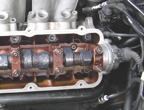

** As far as the driver side, the Hall (camshaft) sensor comes off by removing the two (10 M?) bolts.
You'll have to remove also its mounting bracket to get to the rear seal.
It's definitely a shade tree mechanic job without any sweat.
