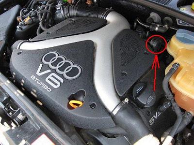

I have a 2001 2.7t. A plastic part has broken off from the intake piping and I am not sure what it is. It looks like it may be a PCV valve or something? It has some letters on it: PA6 GF 30 and 078 129 101A. Any help is appreciated!

This is your spyder pipe - PCV proportional valve.
Whole assembly only.
Get the climate specific one (out of 3 available) from the dealers.
