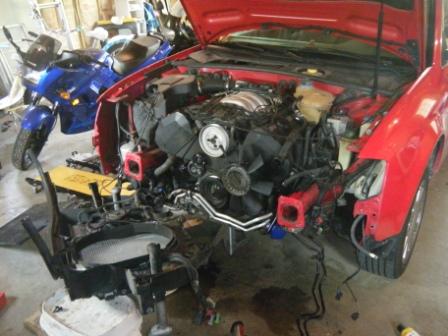

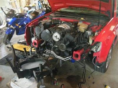

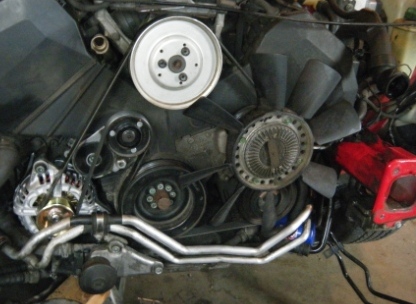

I just replaced mine and there were about six different models to choose from depending on whether you had a Bosch and Valeo model from the factory. I bought a remanufactured 120-Amp Valeo unit from AutoZone for $160. I changed it myself, but it took all day, so that doesn't sound like a bad price you got for the labor. Be sure to have them clean the ground strap connection to the body while they're changing it.
One other option is just changing the voltage regulator, which you can remove without taking anything else off the car. You just have to be sure that the rest of the alternator is okay. The shaft on mine had two huge grooves worn in it, but it also had almost a quarter million miles on it.
