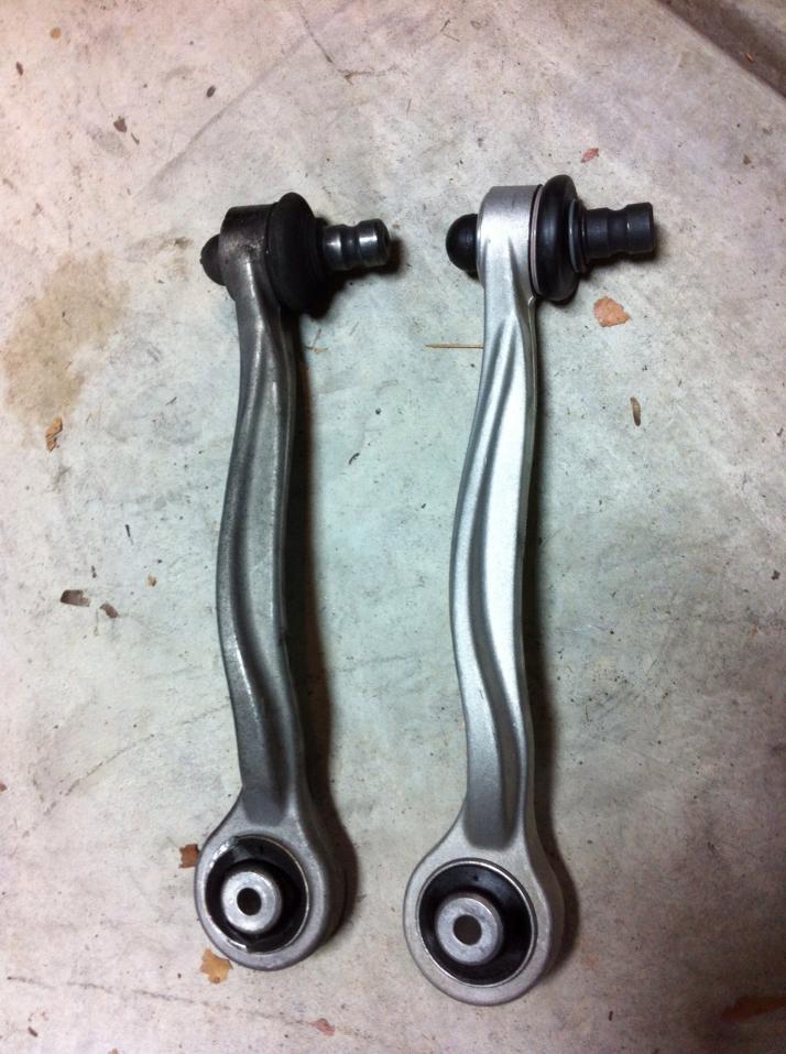

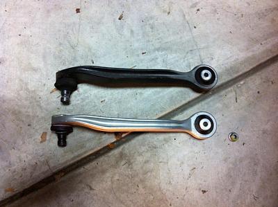

I installed the new upper control arms last week. Here are some pics of the new arms vs the OEMs I took off.
All the arms were shipped in bubble wrap. I removed it for pics.
The OEM is on top (it's black due to someone painting the wheel well.
Side-by-Side OEM is on left.

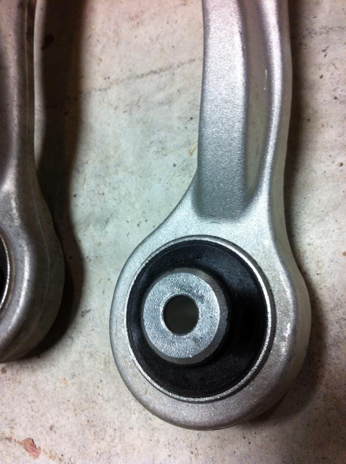

Close up of new arm bushing...it's looks the same as OEM.

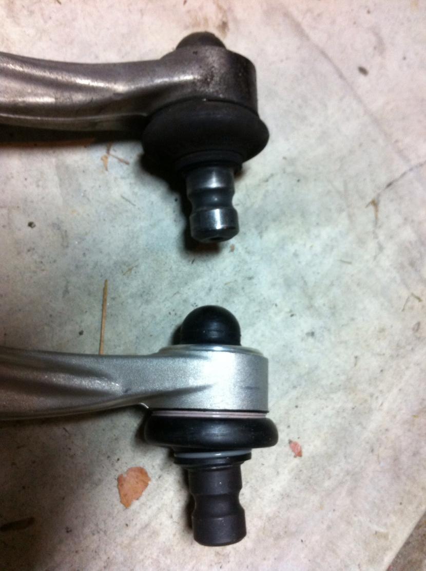

Ball joint. OEM is on top.
